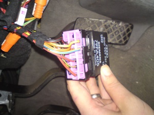

Further to my temp fix I have now resolved the issue.
The fault history was thus, occasionally upon start-up the driver door window switches (didn't check the passenger door one) wouldn't work. The master window switch on the central column next to the cigarette lighter would still operate most windows excluding the driver's window. After between 2 - 10 mins the window switches would begin to work and the centre switch would also operate the driver's window.
The fault was traced to the window control module which occupies a double relay bay adjacent to the steering column behind the dash shelf on the driver's side.
https://www.2carpros.com/forum/automotive_pictures/402500_window_control_module_2.jpg
You can't really miss it; it has a 367 printed in large number on the end.
Per advice I found on audiworld I disconnected the module when the ignition was off and took it to my shed for inspection. slid off the plastic cover and found a dry solder joint (was clearly visible no test meter required) on one of the side circuit boards.
Broke out the solder iron and some lightweight solder, heated the joint cleaned with some flux paste and added a reasonable blob of solder. To be honest the joint wasn't the best I've ever done but I plugged the module back in and hey presto - back in business - SIMPLES!
