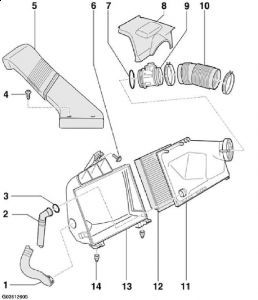

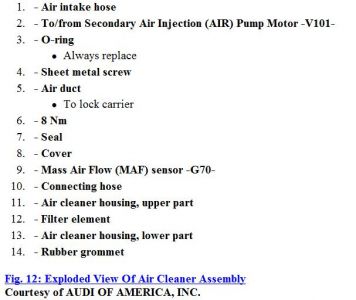

Visual or written instruction on how to replace air cleaner
Sunday, March 15th, 2009 AT 12:32 PM
ZACKMAN
MECHANIC
4,202 POSTS
On #11, there should be a few spring clips to undo in order to remove the top from the bottom housing.
