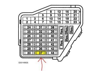

SARDONYX
  • 1998 AUDI A6
Electrical problem
1998 Audi A6
we have located the fuse box on the 98 audi a6, and found a diagram telling us which number fuse it was for the radio, fuse 22-10 Amp (red), the problem is that there are so many "red-10 Amps" we don't know which one is for the radio, help please?
Monday, April 13th, 2020 AT 10:57 AM (Merged)
MHPAUTOS
  • 31,937 POSTS
Hi there Audi 1998, Radio fuse location.
https://www.2carpros.com/forum/automotive_pictures/61395_audi_3.jpg
Mark (mhpautos)
+3
