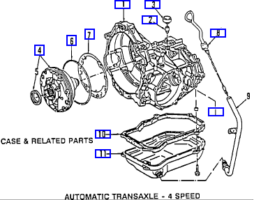

1998 Audi A6 Where is it
CHICO23
  • 1998 AUDI A6
  • 6 CYL
  • FWD
  • 91,500 MILES
I can not find the dipstick to check the tranmission fluid. Where is it located and how could I measure the fluid

IMPALASS
  • 3,112 POSTS
There are several Audi, A6 to choose from so I am not sure which one is your. I gave you info for the Quattro Sedan. It may apply to your car. The other choices are, A6 Quattro Sedan, A6 Quattro Wagon, A6 Sedan, A6 Wagon.
On this model it appears to be on the driver's side toward the back near the fire wall. Hope this help.
https://www.2carpros.com/forum/automotive_pictures/248015_Transmission_1.gif
