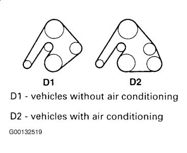

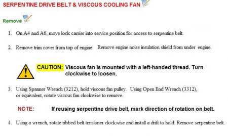

how to replace the belt/loosen the tensioner adiagram would be helpful

Thursday, August 20th, 2009 AT 11:07 PM
