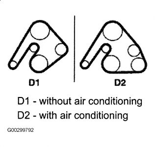

I need the serpintine belt routing for a 99 Audi A4 Quatro with a V6 2.8 5V engine.

Here you go

I want to find out how to route the serpentine belt for my 98 audi a4.6cyl.

Hi
Hope this helps
