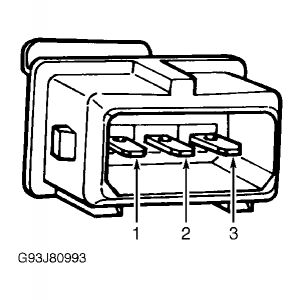

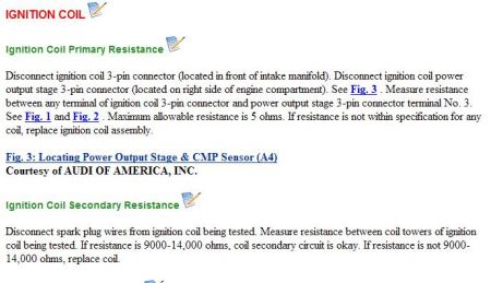

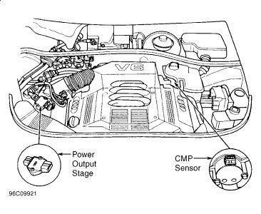

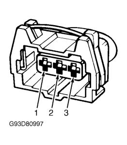

Testing coil.
see text & pics for coil test.
https://www.2carpros.com/forum/automotive_pictures/61395_1_75.jpg
https://www.2carpros.com/forum/automotive_pictures/61395_2_16.jpg
https://www.2carpros.com/forum/automotive_pictures/61395_3_7.jpg
https://www.2carpros.com/forum/automotive_pictures/61395_coil_1.jpg

MHPAUTOS
  • 31,938 POSTS
Hi Rick,
The cam sensor will be a magnetic sensor, it is the movement of the cam gear teeth(am thinking its the same with Audi) that alters the magnetic field or the sensor inducing a pulse signal to the ecu, this is normally tested with an engine oscilloscope, but if the magnet is very weak it wont pulse correctly, ok I know your next question, how strong should it be? Well it wont snap onto a metal surface, but there should be some resistance felt when something metallic is offered up. Can you post the P code you got Pxxxx should be 4 digits.

This is a little complicated than I thought. My ojective is to get that pulse back. Also the open loop in the fuel injector is a problem. The negative terminal of the battery has a 12 volt, I mean there could be a short. When I connect a test light between the cable to the neg-terminaal post, the light iluminate. How do I segragate this situation?The cam sensor seems to be fine when I took it out and inspect it manually. The coil has infinite resistance and there is no 9000 to 10500 OHMS. Does this mean the coil is okay? Sorry that I"m coming from different angles.
Can you help me clear some of my concerns.I will work again in this car soon and I'm still expecting a positive outcome.
