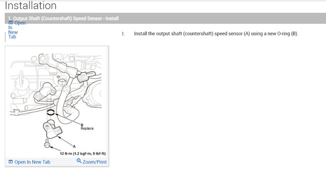

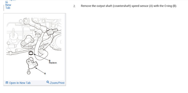

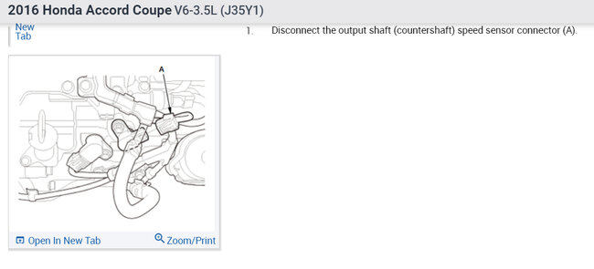

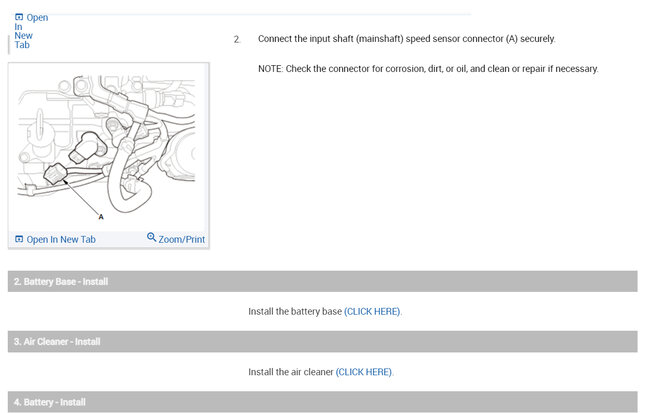

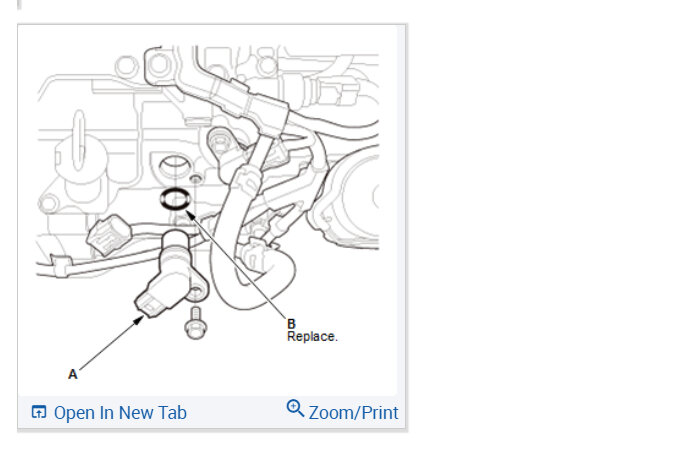

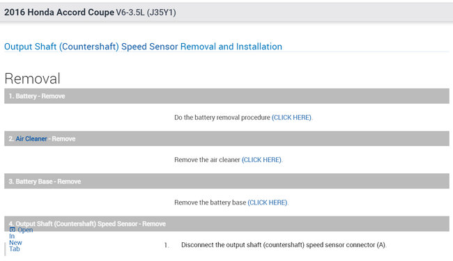

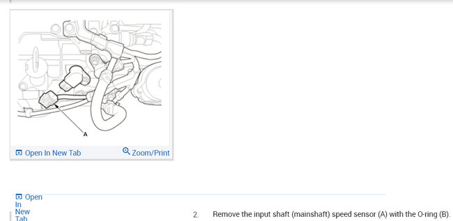

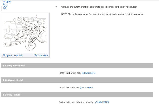

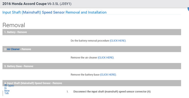

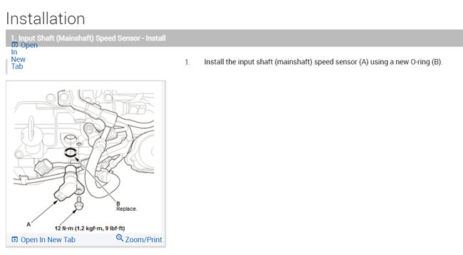

I know the location of where to find the AT speed sensors, but i want to know if they are all the same and look alike? Or are they two different?
Jul 16, 2023 at 1:36 PM
  • CAR REPAIR CONTRIBUTOR
  • 54,193 POSTS
It looks like both the input and output speed sensors right next to each other near the dipstick. Check out the images (below). Please let us know if you need anything else to get the problem fixed.
