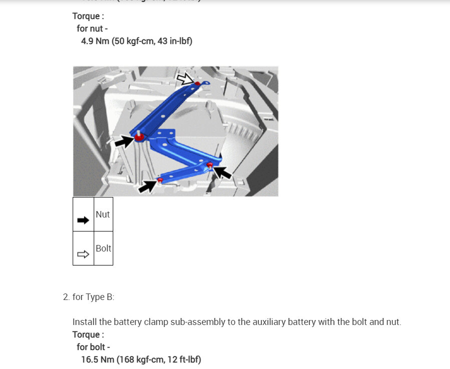

anything special about replacing the 12v battery on this vehicle?
2016 TOYOTA RAV4 HYBRID
75,000 MILES
CARCOULDCARELESS
  • 9 POSTS

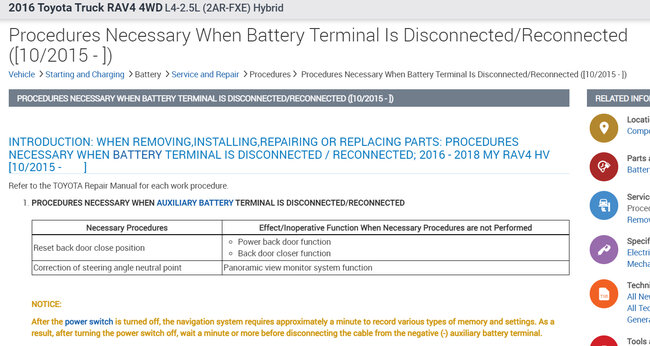

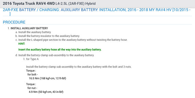

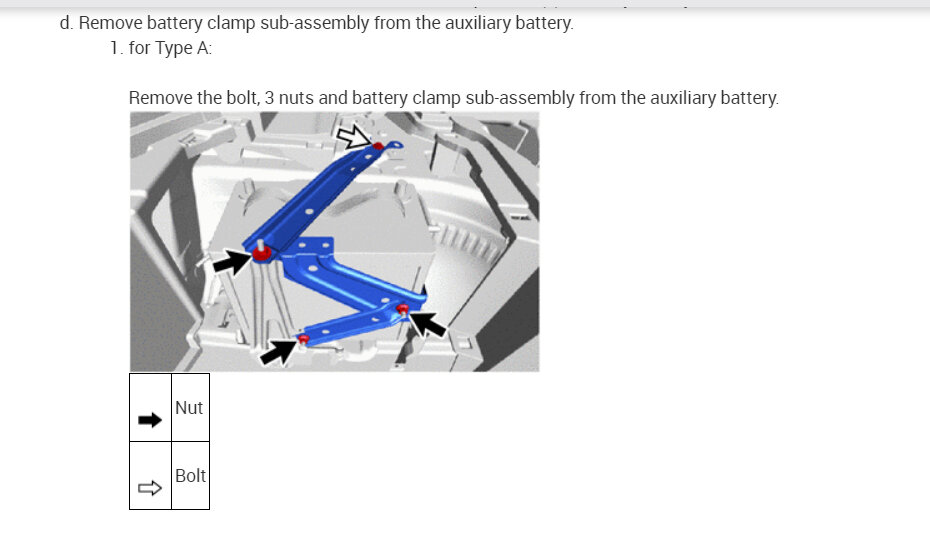

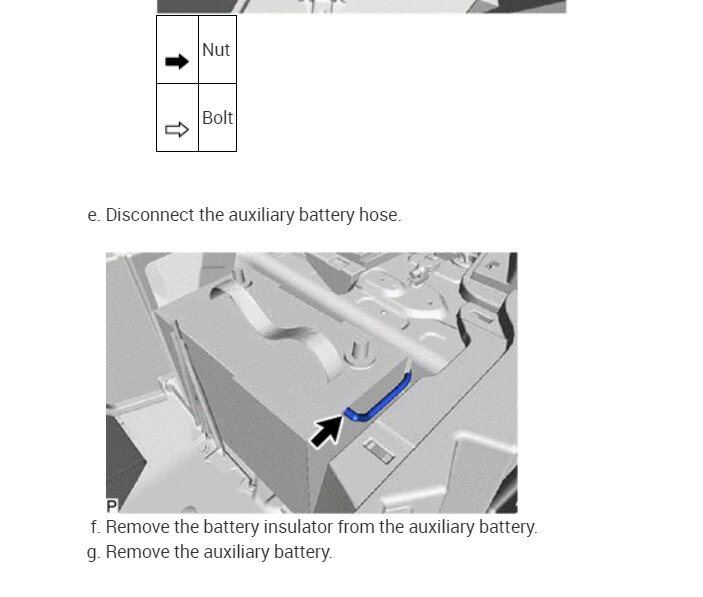

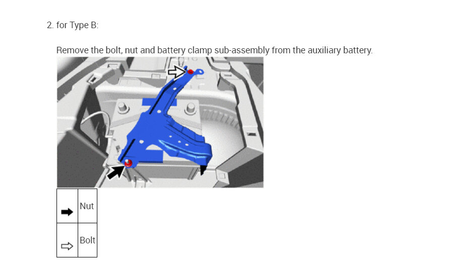

I have not replaced my 12v battery (the aux battery, not the traction battery) and wanted to do a pre-emptive replacement. AutoZone and advanced auto usually replace batteries for free, but not on this model! Is there anything difficult about doing this? (it *looks* like it should be easy, but I have been told there is a vent tube (don't know where that is or what that is). I would also like to keep the computer operational (is it okay to use the jump start location (red tab and ground) on this car like you showed in one of your videos on this car?
Nov 30, 2022 at 5:34 PM
  • CAR REPAIR CONTRIBUTOR
  • 54,209 POSTS

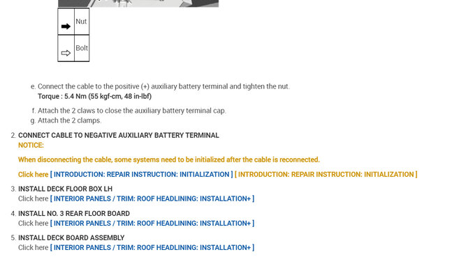

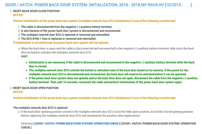

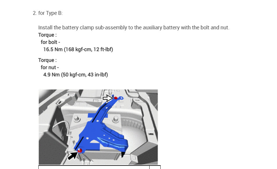

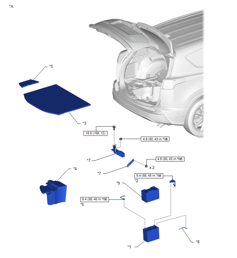

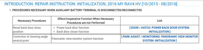

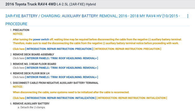

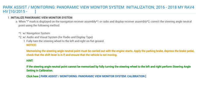

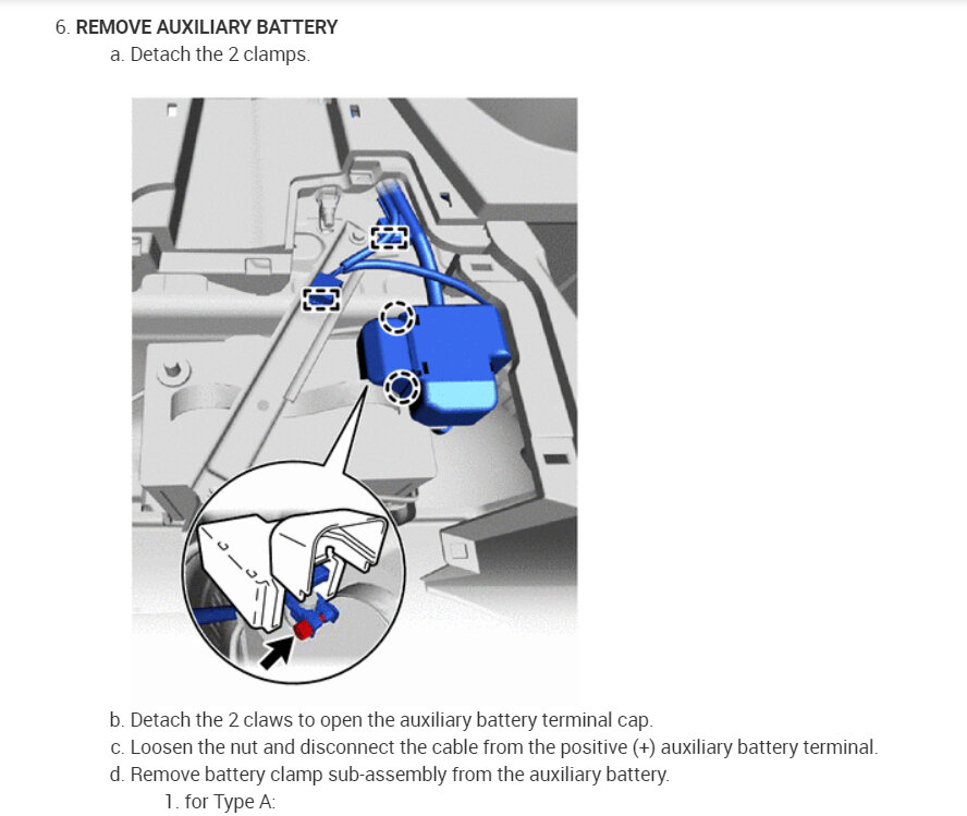

Yep, there is a vent tube which needs to be reconnected and you will need to reinitialize the rear door closer and the parking assist if you don't use the 12-volt power jump ob like in the video below. Here is the video for reference, you will need to rig your own set up. I have included the instructions on how to change the 12-volt battery out and do the reinitialization in the images below in case the power source comes undone or you don't have one.

4) if I don't use the jumper connection, the only data lost would be door data and parking assist?(what about radio presets, door settings, key fob, etc)

I can't make a PDF file out of the instructions, but you can click on the images to copy.

4. It did not mention the radio, seat etc memories having to be reset, so this will be trial and error, but I would assume it will.

Well, I finally did it. the instructions you provided were excellent....It was not as hard as I thought it would be. I did not have to use a backup power (jump start location) to keep the data. It must be powered via traction battery? (the stuff on the + cable is much more than a regular battery.....just left it alone and treated it like a regular battery terminal ;)
the only data that got lost was a power back door (just need to close it manually, then open and close driver side door)---back in business ;)
also got rid of a message in maintenance that I had set up...but not a big deal.
