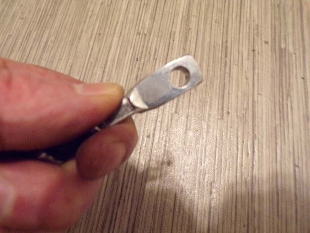

I have had to rebuild the entire rear right suspension in that a new (used) trailing arm, lower wishbone, suspension spring (the one on there was broken!!), bearings, hub, rotor, brake pads, parking brake pads, parking brake cable and complete output shaft (as the CV joint wouldn't move freely) had to be replaced. This was due to discovering that the prior owner had hidden the damage done from an accident that most likely happened in this area as when putting the bolts back in for the upper and lower wishbone to the trailing arm the holes wouldn't match. It was impossible to install the bolts back. Hence why the entire rebuild of this area.
Everything has been done apart from the parking brake cable being reinstalled. It has been installed at the hub end and attached to the parking brake shoes, but when trying to route and snake it back into the chassis so that it can be attached to the handbrake, it is impossible to put back.
The length of threaded rod goes into the hole where the cable originally exited the chassis, but it goes no further and there is approximately 18" of cable left to thread back in.

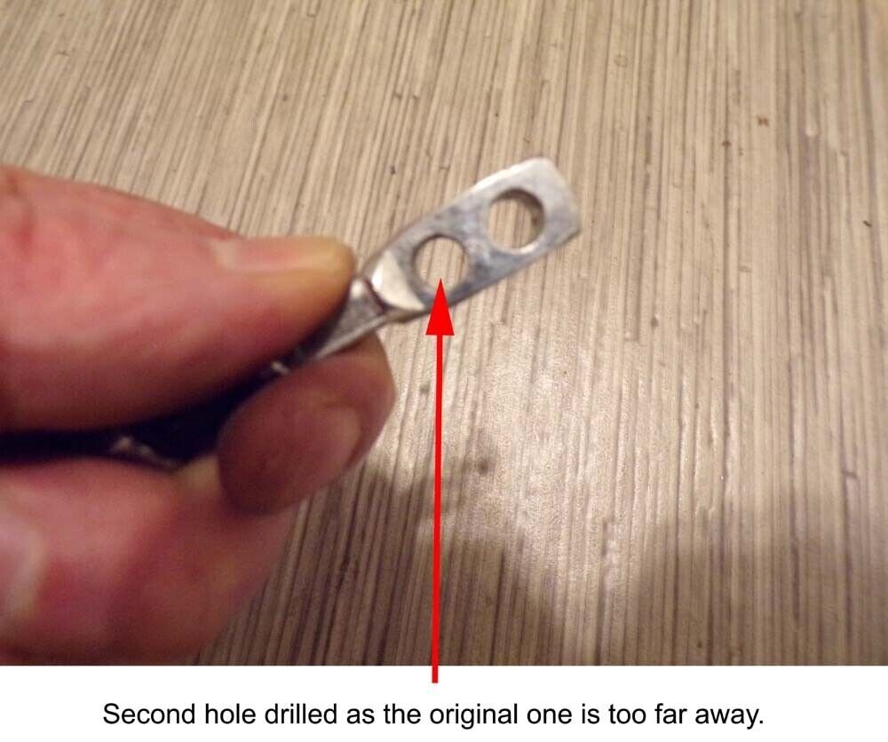

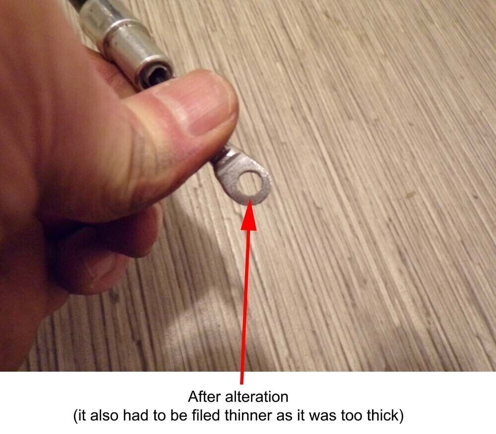

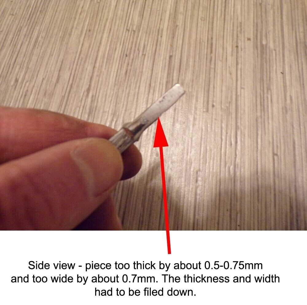

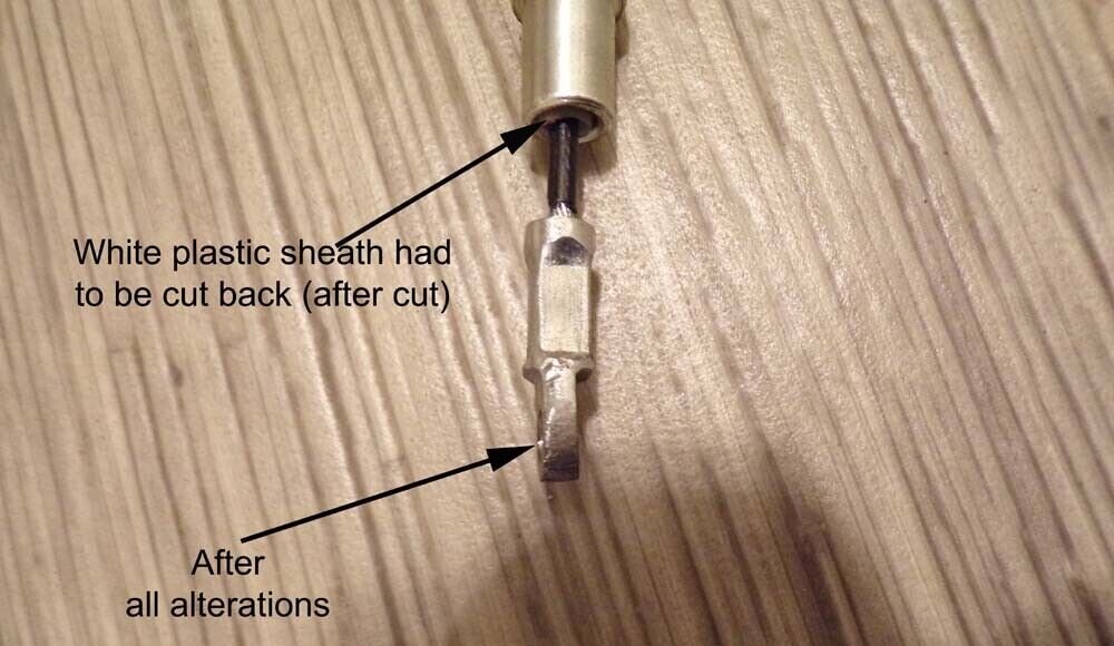

I had to do extensive modifications to the new cable at the brake shoe end (see images) and I have just had a thought that maybe I need to file down the metal at the base of the threaded rod as it is slightly 'fatter' there.

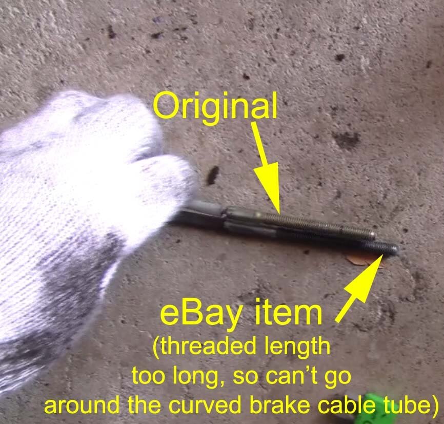

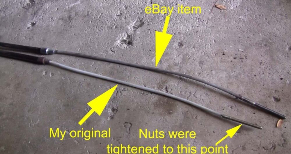

An update.
Yesterday, after over a week of trying to get this cable fitted with no luck, I discovered what the problem was the wrong length of cable and the wrong length of the threaded end! See images for a clear explanation.
The end with the thread was 0.5" too long which prevented it from moving around the curves in the tube that went to the hand brake. The tube went from the top of the transmission tunnel, along it for little ways, then curving over to the top of the tunnel to the hand brake. That extra 1/2 an inch prevented it from moving around those curves. And that is why it wouldn't go in beyond a certain point!
I also have a video of the tube itself, as I purchased an endoscope to see what the heck was going on inside the tube/chassis, which I will post soon. But that threaded end was long enough to prevent it moving through those curves. Needless to say, I am getting a refund on the eBay item and have ordered a new cable locally which I will be picking up on Thursday (tomorrow).
Note: The original cable looks in better condition than the new one. The original was rusted into the hub end and the plastic had cracked at the juncture between the metal ferule and the cable. So, I went ahead and tried replacing it.
