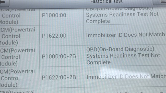

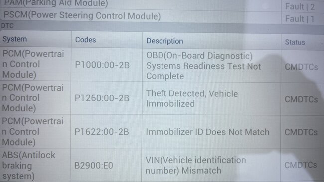

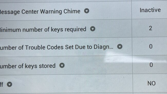

Unable to program keys after waiting for the 10 minutes as required by the system. It says key programming failed. Have codes like p1260:00-2B. P1622:00-2B. B2900:E0.

Do you have the Autel MaxiIM IM608PROIIKPA, MaxiIM IM508S, and MaxiIM KM100? These are designed to program automotive keys and fobs.
P1260:00-2B - Theft Detected, Vehicle Immobilized
P1622:00-2B - Immobilizer ID Does Not Match
B2900:E0 - Vehicle Configuration Mismatch

Yes, lost keys.

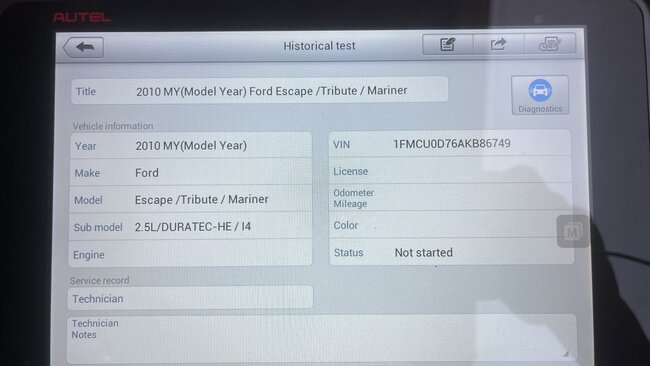

1FMCU9EG6BKA06593 This vin is the Chassis, on the left windscreen.
1FMCUOD76AKB86749 This Vin is the current ecu found in the car, meaning the previous technicians had replaced it.
In order to be on track, if I may have the immobilizer pin out for this 2 units I can verify where the mismatch is coming from.

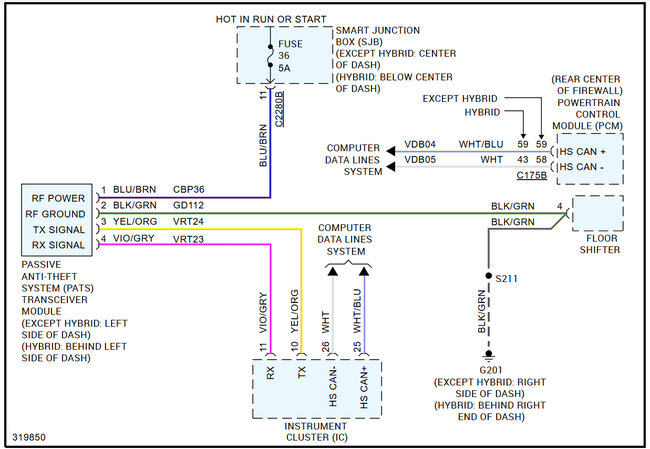

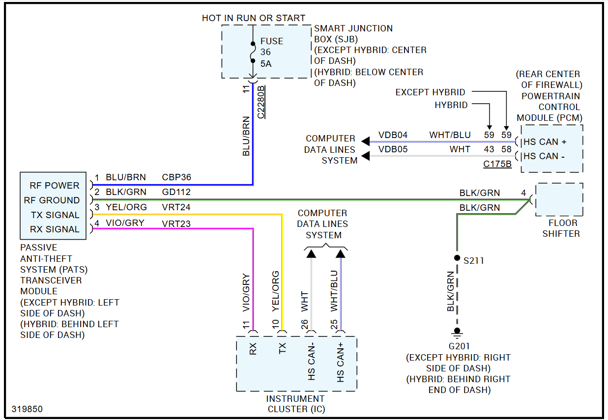

It seems like the PATS transceiver module is bad. Here is the wiring diagrams for it. Check out the images (below).

I had double checked this, the transceiver is ok, actual problem is the main pcm has been replaced, the previous was a 2010 and the new is a 2011, I have an error code of VIN mismatch and key code mismatch.
I wonder if the change could be the problem.
Tuesday, April 22nd, 2025 AT 1:22 PM
KEN L
  • MASTER CERTIFIED MECHANIC
  • 55,522 POSTS
Yep, that will do it, that would have been good info to have.

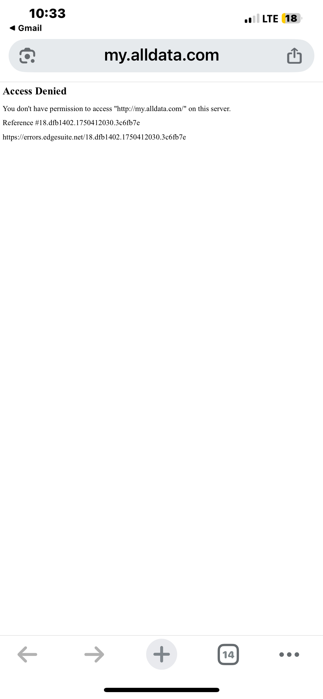

ANDRIN ATEM
  • 422 POSTS
Access denied.
Friday, June 20th, 2025 AT 2:34 AM
KEN L
  • 55,522 POSTS
Sorry, try alldata. Com
