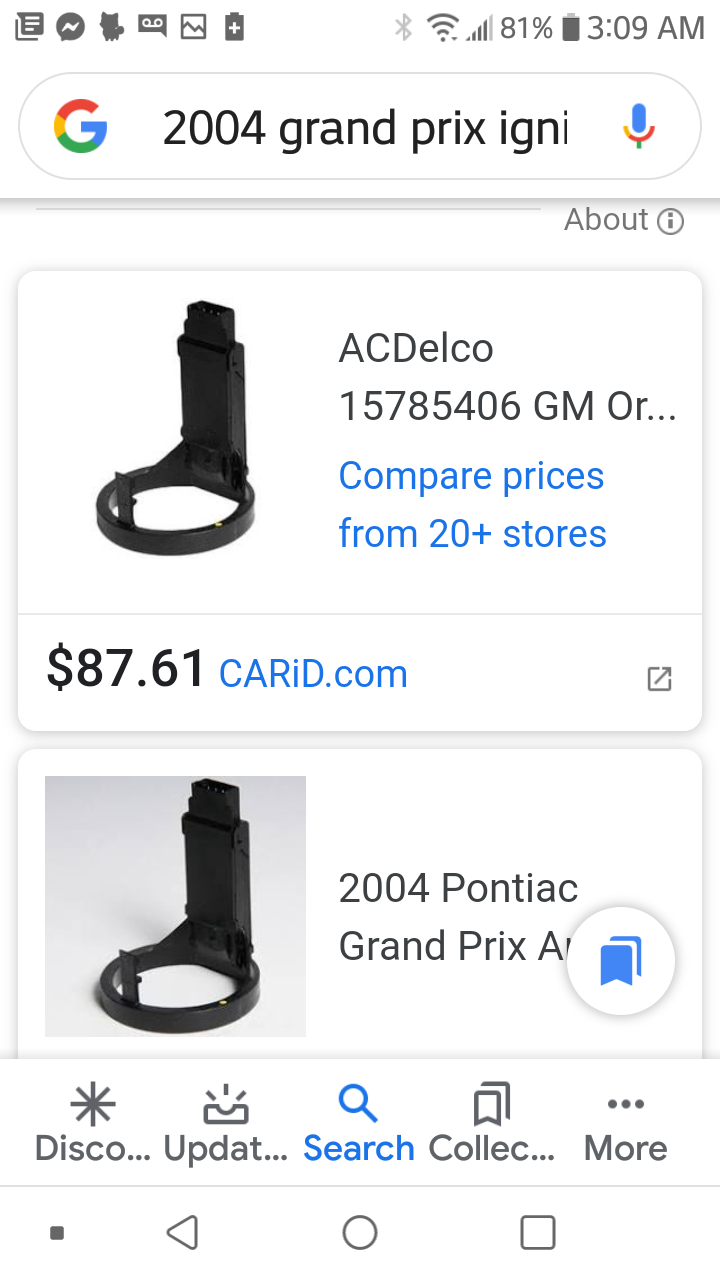

Okay, the ignition is on the dash not the column. I am replacing the ignition lock tumbler and i broke the anti theft module so too. So do i need to go have it program by a locksmith now or can i do it myself?

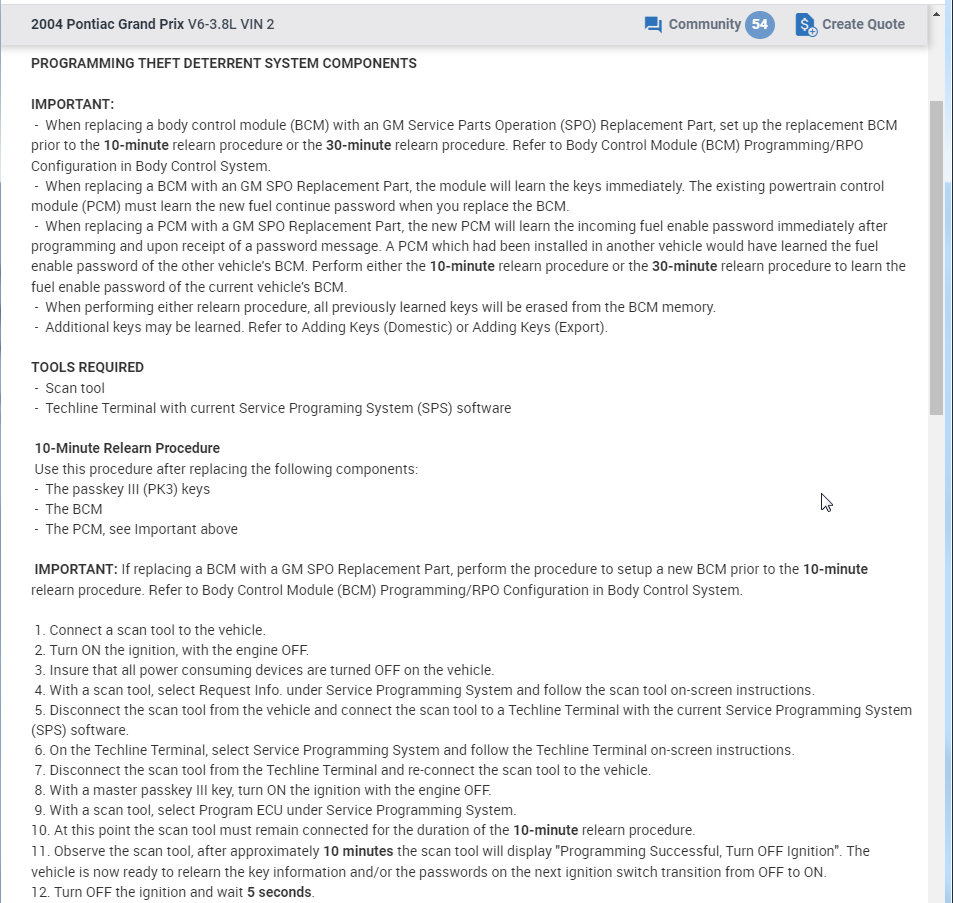

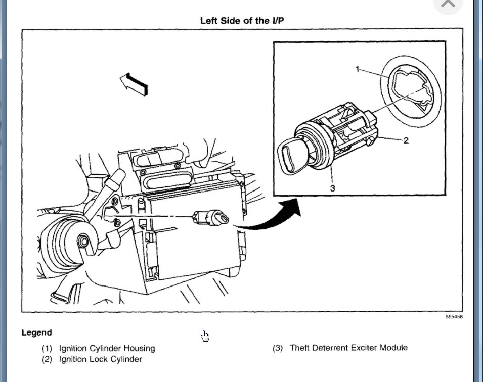

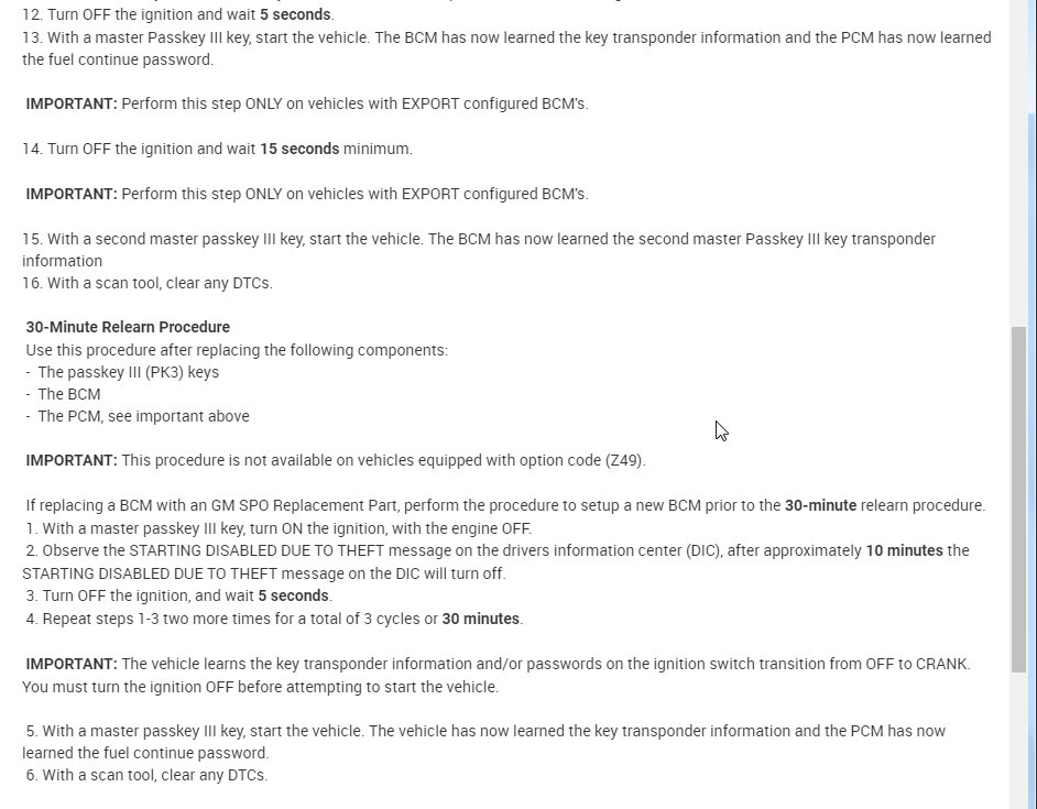

When you say the theft module, are you talking about the deterrent exciter module that is shown in the picture below? If so, I also attached the programming of the system and this is not listed as it is just a transmitter that the BCM energizes and does not require programming. Let me know if you are talking about something different. Thanks.
Aug 22, 2020 at 2:16 PM

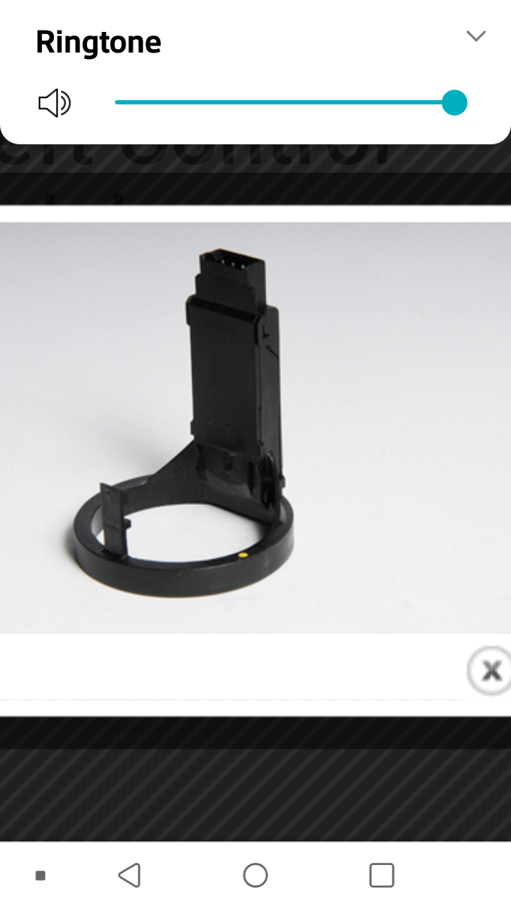

This is the part i am talking about it plugs into the ignition switch and the round end goes around the lock tumbler from all i have read about it is reads the key its a phase III key i. the round part is what i broke and it has fine copper wires that goes to the part that plugs into the ignition switch its a sensor i believe.
Aug 24, 2020 at 3:05 AM
Okay. Yes. This is the part that I mentioned and it does not appear to require programming.
