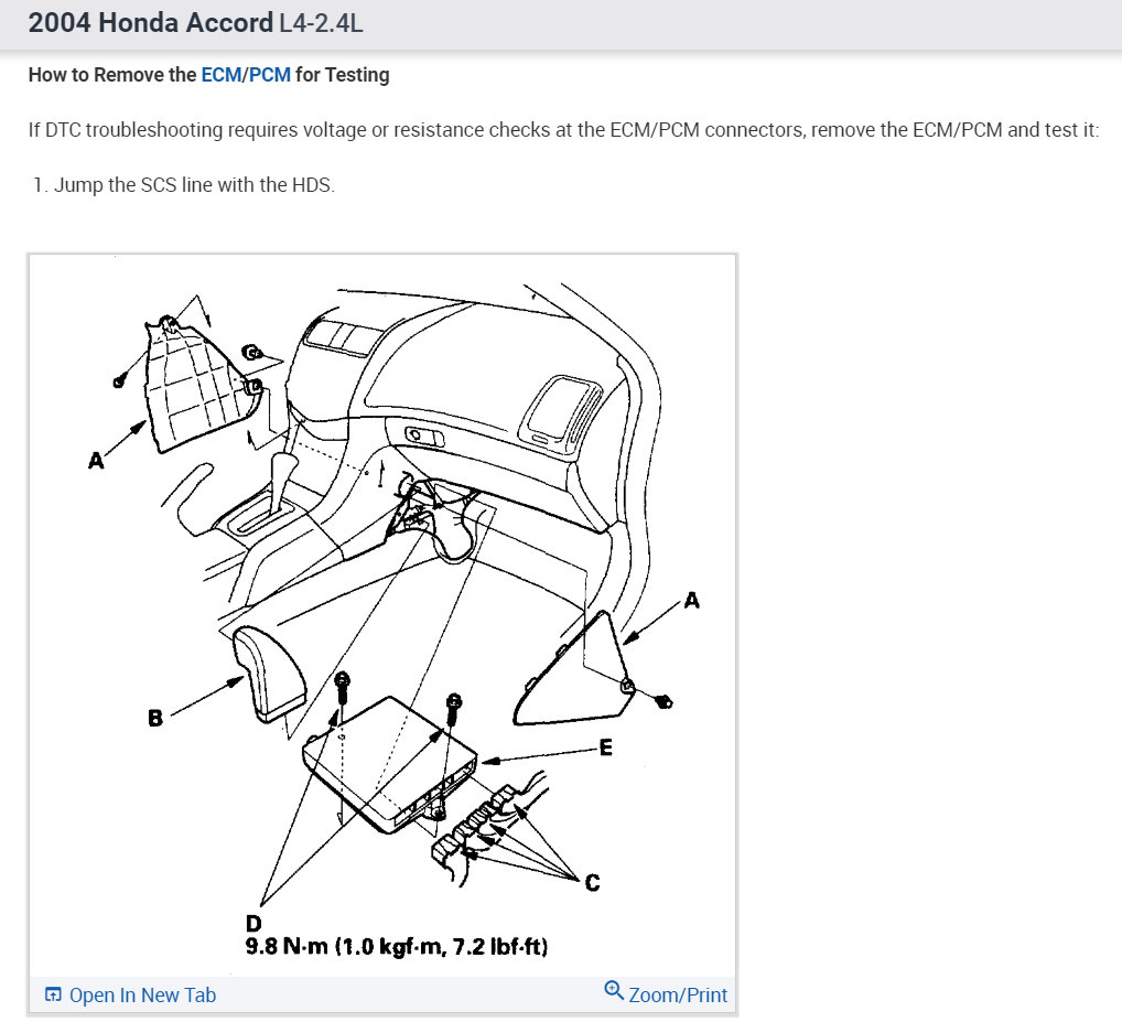

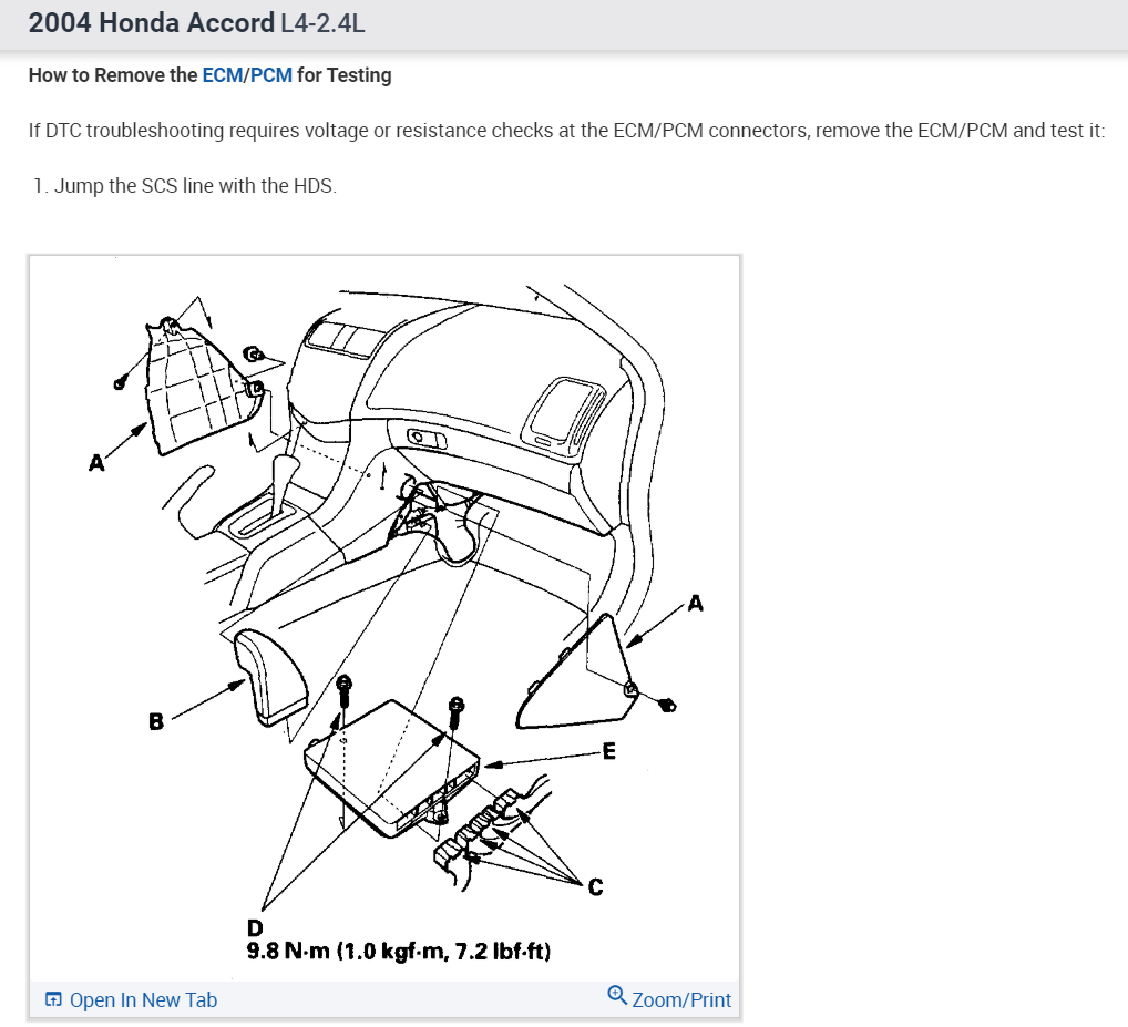

I just purchased this car, the immobilizer light always is flashing and it's throwing code p0603. I've replaced both the car and key batteries. The car cranks and runs like it should but the transmission will not go into gear. I can't push the button and the little hole that your supposed to be able to shift gears with it off will not work either. Any help?
+1
Saturday, September 26th, 2020 AT 1:16 PM (Merged)
KEN L
  • MASTER CERTIFIED MECHANIC
  • 55,488 POSTS

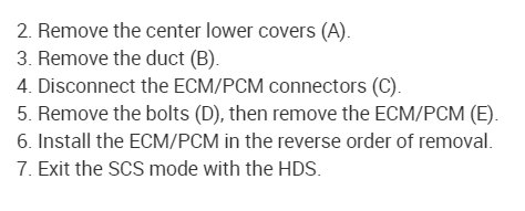

P0603 DTC code which refers to the Keep Alive Memory in the PCM power-train control module. This is telling us the PCM needs to be replaced or the internal battery replaced. (I am not sure if you can replace the battery.) This should take care of the security issue as well. Here is the PCM location and how to replace it. Please give your VIN number to the re-builder when purchasing the unit.
HDS Clear Command
The ECM/PCM stores various specific data to correct the system even if there is no electrical power such as when the battery negative terminal or No. 8 FI ECU (ECM/PCM) (15 A) fuse are disconnected. Stored data based on failed parts should be cleared by using the "CLEAR COMMAND" of the HDS, if parts are replaced.
The HDS has three kinds of clear command to meet the purpose. They are DTC clear, ECM/PCM clear, and CKP pattern clear. DTC clear command erases all stored DTC codes, freeze data, and readiness codes. This must be done with the HDS after reproducing the DTC during troubleshooting. The ECM/PCM clear command erases all stored DTC codes, freeze data, readiness codes, and all specific data to correct the system except CKP pattern. If the CKP pattern data in the ECM/PCM was cleared, you must do the CKP pattern learn procedure. The CKP pattern clear command erases only CKP pattern data. This command is for repair of a misfire or the CKP sensor.
DTC CLEAR
1. Clear the DTC with the HDS while the engine is stopped.
2. Turn the ignition switch OFF.
3. Turn the ignition switch ON (II). Wait for 30 seconds.
4. Turn the ignition switch OFF, and disconnect the HDS from the DLC.
ECM/PCM RESET
This command clears stored specific data from each vehicle such as DTCs, freeze data, and readiness codes. It does not clear CKP PATTERN data.
1. Reset the ECM/PCM with the HDS while the engine is stopped.
5. Do the ECM/PCM idle learn procedure.
CKP PATTERN CLEAR/CKP Pattern Learn Procedure
Enable Criteria
ECT at 176 °F (80 °C) or higher.
Procedure
1. Clear the CKP pattern with the HDS while the engine is stopped.
2. Turn the ignition OFF.
3. Turn the ignition ON (II), and wait for 30 seconds.
4. Test-drive the vehicle on a level road. Decelerate (with the throttle fully closed) from an engine speed of 2,500 rpm to 1,000 rpm with the A/T in 2, or the M/T in 2nd or 3rd gear.
5. Stop the vehicle. Do not turn the ignition off.
6. Select the ALL DATA LIST in the DATA LIST MENU of the HDS.
7. Check the status of PULSER F/B LEARN. If it is set to NG, the enable criteria was probably not met; repeat the procedure from the beginning.
How to End a Troubleshooting Session (required after any troubleshooting)
1. Reset the ECM/PCM with the HDS.
2. Do the ECM/PCM idle learn procedure.
3. Turn the ignition switch OFF.
4. Disconnect the HDS from the DLC.
NOTE: The ECM/PCM Is part of the immobilizer system. If you replace the ECM/PCM, it will have a different immobilizer code. In order for the engine to start, you must rewrite the immobilizer code with the HDS.

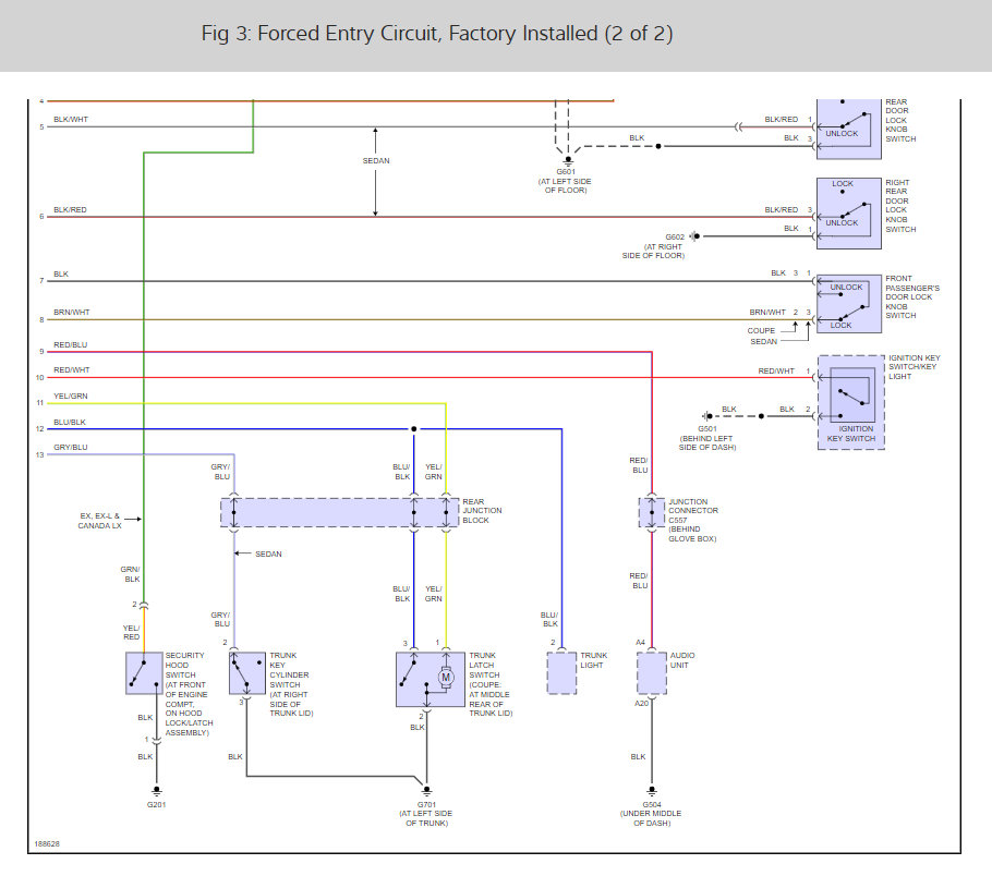

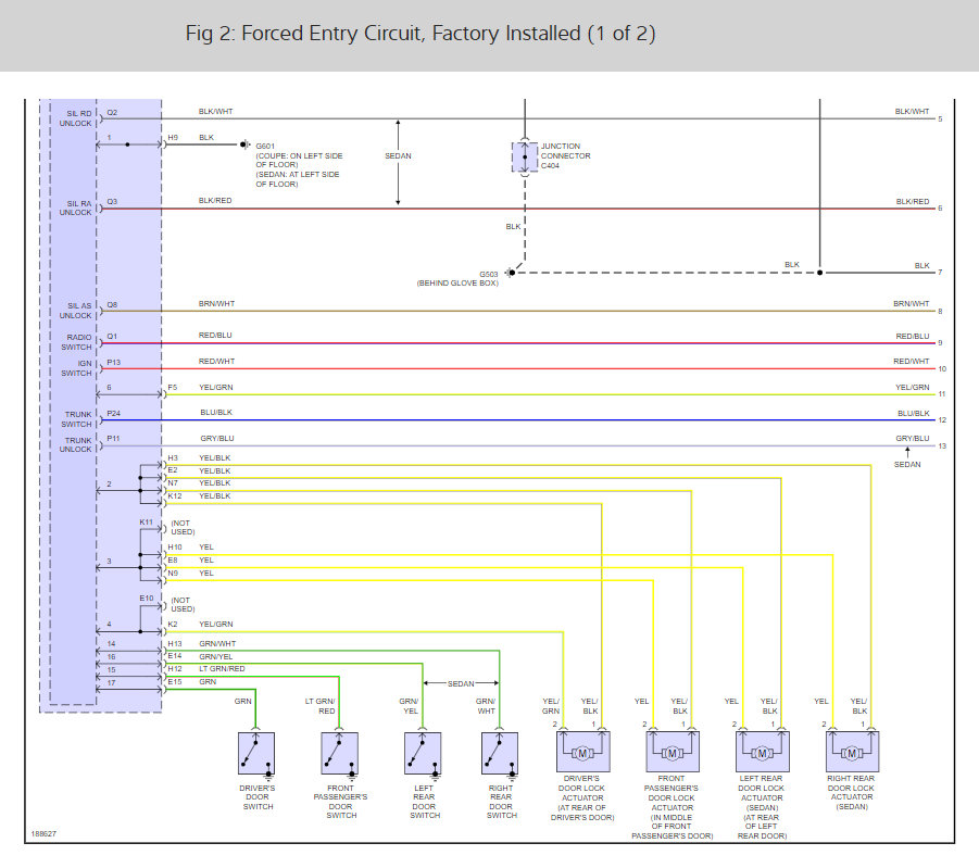

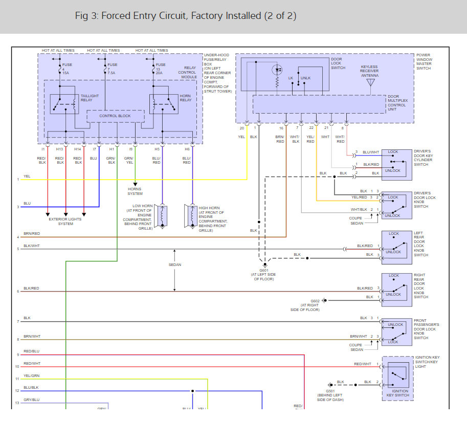

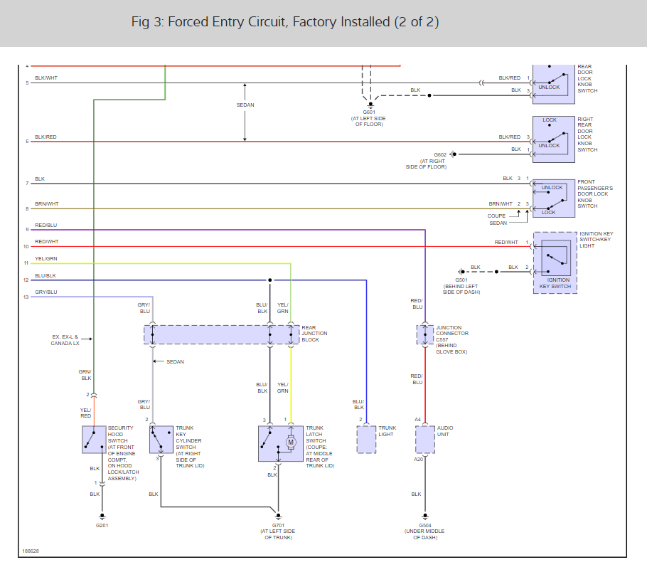

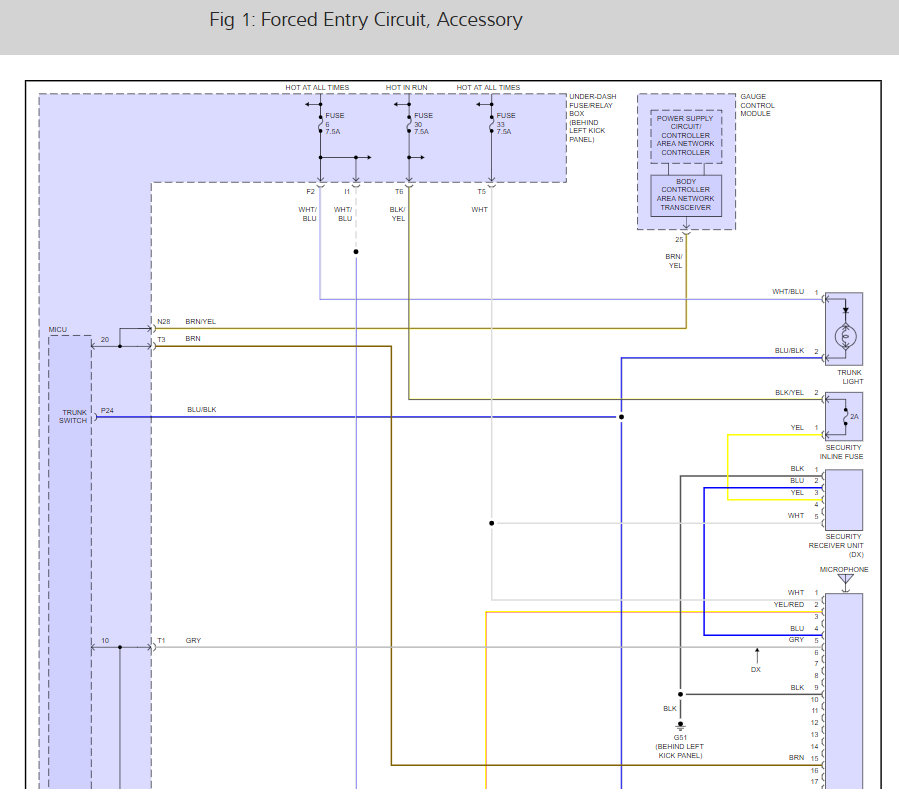

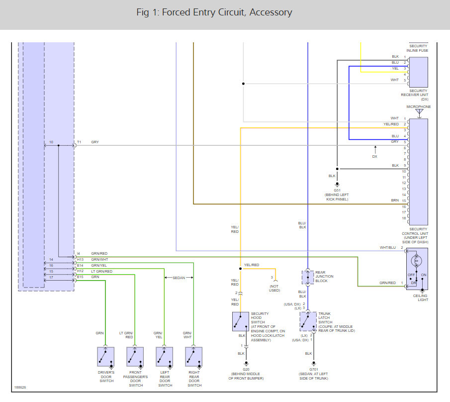

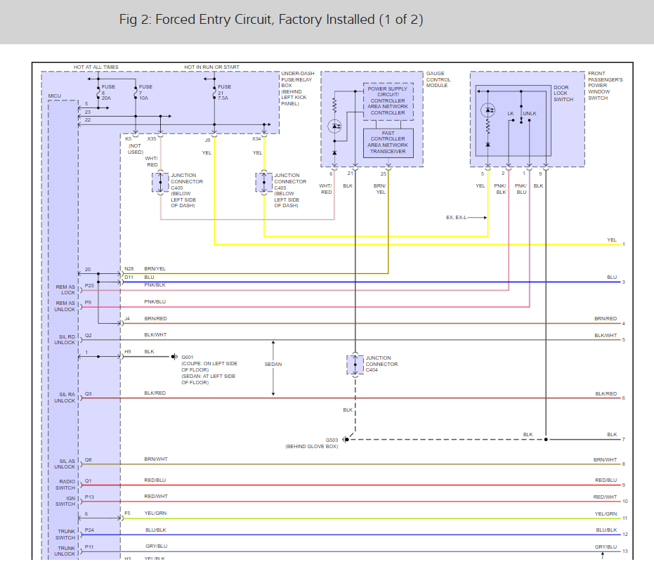

I recently bought my first car and every time I turn off the car my head lights flash. My horn fuse is blown, but the security system is going off. So I have to turn off and on my car to get the lights to turn off and play with the controls for headlight. The steering column has been changed out and my driver door inoperable because the cylinder damage. It drives and turns on, the remote does not unlock and lock doors. How do I fix it?
Saturday, September 26th, 2020 AT 1:17 PM (Merged)
KEN L
  • 55,488 POSTS
It sounds like the door lock is the issue it must work so the security system can be disarmed. Here is a wring diagram of the alarm system so you can see how it works. Can I ask what happens tot he door lock and what do you need to fix it? It sounds like one of the horns is shorted causing the fuse to blow. You can see by the wiring diagrams the door locks and latches must be working. Also, check the system fuses. The wiring diagrams will show you which ones.
Check out the diagrams (below). Please run this test and get back to us.

My Honda Accord V6 is equipped with a secyrity system that will sound the horn and alternate with flashing the headlights, parking lights, side marker lights and taillights if someone attemps to break into the car or tries to remove the radio.
My problem is: Since the last time I brought it to the dealers' workshop for oil change and maintenance this alarm goes on for no reason at all when the car is parked and the doors are locked! This can happen at any time of the day or night, inside the garage, in the driveway or on a parking place. I brought my car back to the dealer's workshop to have this problem solved, they checked the computer and the security system for 1 hour and a half but unfortunately the problem did not show up while I was there, Cost: $110.00 no results" This problem is very annoying, as I have to reset the alarm with the remote transmitter and this may take a few seconds before it is done. My scare is that my neighbours will soon start to throw rocks at my car? Thanks for your help!
RAY.
KHLOW2008
  • 41,814 POSTS
Hi RAY,
The triggering points for the alarm are the door and hood switches. Most often an out of alignment door would cause the door switch to come into contact triggering the alarm.
This guide can help us
https://www.2carpros.com/articles/how-to-reset-a-security-system
If you have in instances witnessed the door ajar indicator flashing while driving, the at least one of the door switch is not fully in contact. Check the door switches for missing rubber seals, stoppers.
The other item to check would be the hood switch, ensure it is correctly adjusted.
