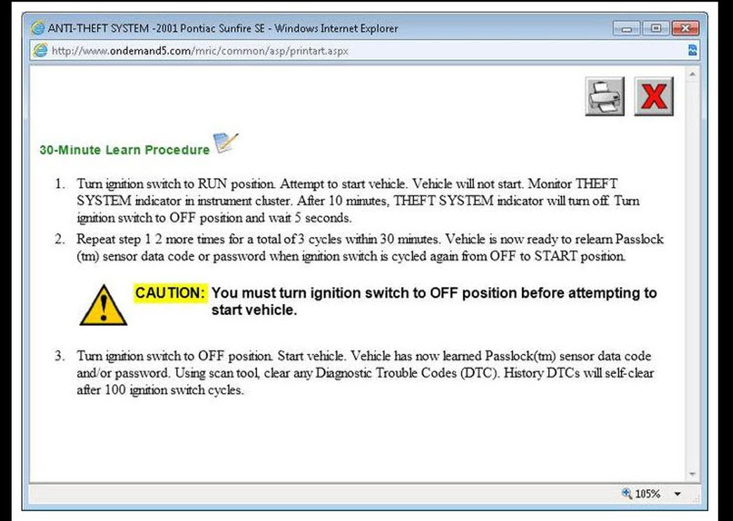

Try resetting security system with instructions below
https://www.2carpros.com/articles/how-to-reset-a-security-system
otherwise it may need a different key if you have one. Not a new one. Check out the diagrams (Below). Please let us know what happens.

You must have the key on for 30 minutes until the security light stops flashing then turn the key off and then start the engine within 5 seconds. Here is a a guide that will help
Please run down this guide and report back

This procedure allows relearning of BCM or PCM learned data code after replacement of BCM, sensor or PCM. DTC B3031 will set when entering programming mode.
Turn ignition off. Replace failed component. With transmission in Park (A/T) or Neutral (M/T), momentarily turn ignition switch to START position (engine will not start), and then leave in RUN position. SECURITY indicator light will stay on for 10 minutes. After 10 minutes, when light turns off, turn ignition switch to OFF position for 5 seconds.
Repeat step 1 twice more. Auto learn procedure will be completed during next start attempt. If VCM/PCM was replaced, reprogram VCM/PCM

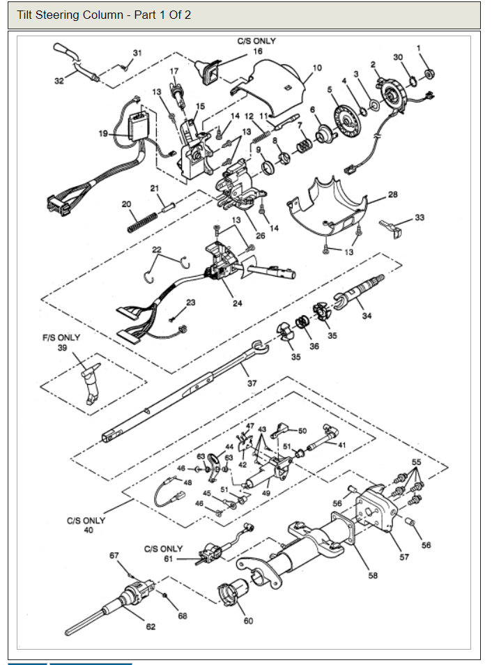

My vehicle will not start. The security system will not let fuel pump start. Have tried to bypass it but still does not start. Do you have an image of the under carriage wiring from fuel pump? Is it possible to just bypass fuel pump? Please help.
Wednesday, March 17th, 2021 AT 12:52 PM (Merged)
KEN L
  • MASTER CERTIFIED MECHANIC
  • 55,516 POSTS
Even if you get the fuel pump to run it still will not start becasue of the security system. If you have not changed the key or lock and tumbler then there are two small wires at the ignition tumbler that break inside the steering column. Here is a guide and some diagram (below) to help you get the problem fixed.
(Check out the diagrams below) The wires that break are attached to item #19
-1

How do you bypass the pass-lock key on my 1998 s10? If any one can give me some input i'd appreciate it, thank you.
Wednesday, March 17th, 2021 AT 12:54 PM (Merged)
WRENCHTECH
  • 20,761 POSTS
This bypass is for the key sensor only. The rest of the system has to be operational.
Here is a video that will help you
https://youtu.be/pyp8Ti-0AUE
If you find the black wire and the yellow wire from the pass-lock sensor in the column you can solder in a 2.2 K ohm resistor and then attempt to start the car.It will stall don't turn the ignition off.Let the ignition on for ten minutes or until the theft light goes out.Turn the key off for ten seconds then attempt to start the car.If it now runs you have been successful.If it doesn't you either made a mistake or there are other problems besides the ignition lock cylinder.
