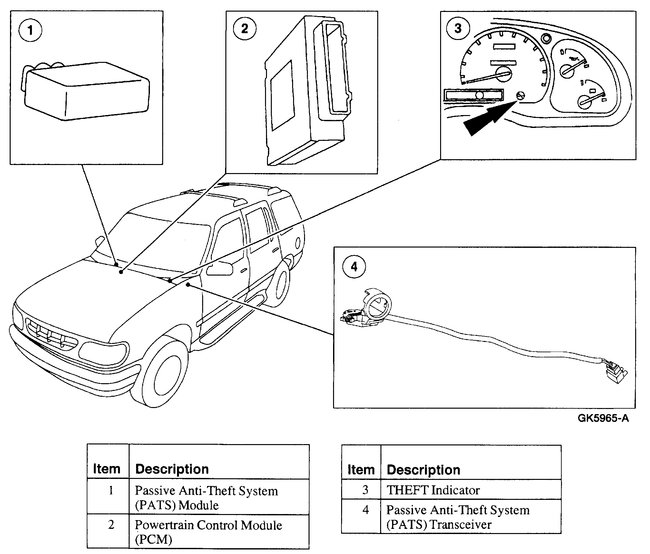

I have no idea what else to try after trying everything. Ford dealer wants to charge me an arm and a leg so I want to fix myself if possible.

I would be happy to help! First we will need to retrieve the trouble codes from the passive anti theft system module (pats) and the power-train control module (PCM). This will direct us to the correct pinpoint test procedures to use. I've attached a picture of the system components to give you an idea of what's involved.
