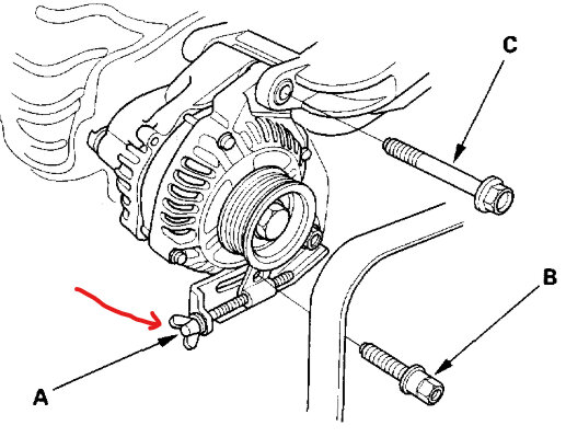

Alternator tensioner adjuster bolt size?
2003 HONDA CIVIC
200,000 MILES • 1.7L • 4 CYL • 2WD • AUTOMATIC
DAELIZANT
My wingnut/bolt (adjusting bolt) on my alternator bracket came off while on the freeway, Where can I buy a replacement one and what are the dimensions of the bolt ? And if I could know how to properly adjust and get it to stay with out coming out due to vibrations?
If photo loads I’m referring to ( A )

Sorry the image did not load, it take a while on mobile so be patient. I see the wing nut bolt in this diagram, this will be a dealer item, or you can use a regular bolt from the hardware store. It looks like it is 8mm 1.25 or 1.5 thread pitch 5 inches long. It might take a few tries. Check out the images (below). Let us know if you need anything else.
