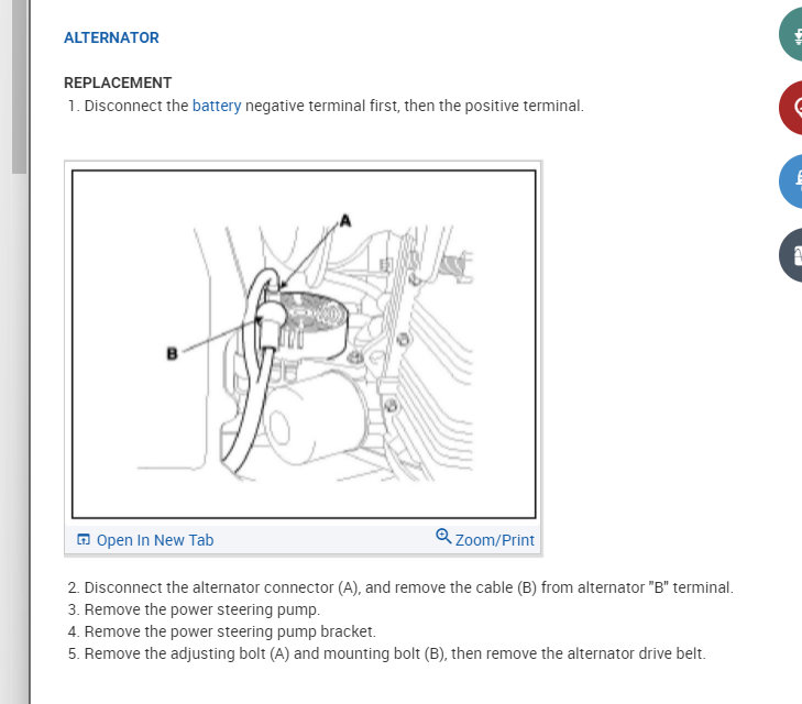

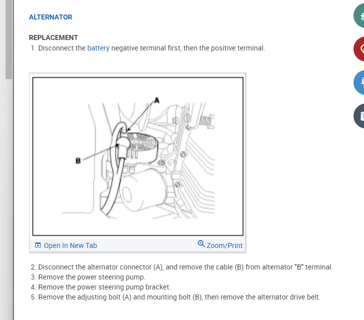

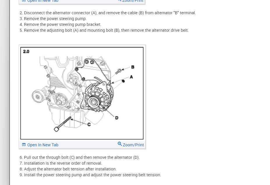

Cant get alternator off
Apr 27, 2013 at 9:48 PM
Let us know what issue you are having with getting it off and we can see what other details to provide you with in order to get this completed.
However, here is a guide that will help with this:
Also, I am attaching the info below on how to replace this which should give you the details needed.
Let us know what issues you are having, and we can go from there. Thanks
