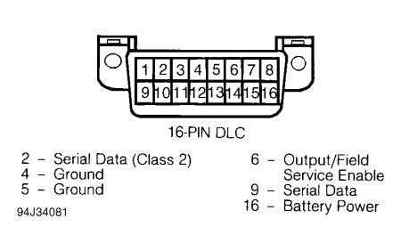

Help with OBD II not connecting please.
Monday, April 5th, 2010 AT 9:46 PM
2 Replies
DOCFIXIT
  • 18,828 POSTS

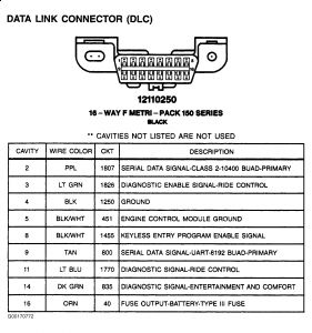

O.K. what's happening is system is OBD II but in 94-96 system was in transistion and did not become readable by OBD II scanner till 97. What is needed is a TECH 1 scanner and only GM dealer will have and will be hard to find.
https://www.2carpros.com/forum/automotive_pictures/198357_Graphic_434.jpg
95 16 pin
https://www.2carpros.com/forum/automotive_pictures/198357_Grafic_3_119.jpg
97 16 pin OBD II
Hope this helps Ernie
