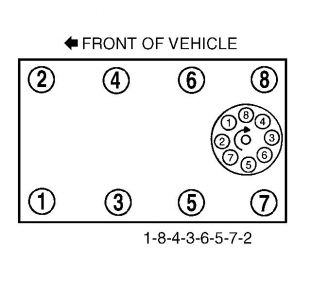

What is the firing order on a dodge ram 1500 1998
Sunday, October 7th, 2018 AT 7:55 PM (Merged)
BMRFIXIT
  • 19,053 POSTS
Engine size ??????
what I have here is for v8 with 5.2
https://www.2carpros.com/forum/automotive_pictures/99387_99ram1500_1.jpg
MOPAR-ESKRIDGE
  • 1994 DODGE RAM
1994 Dodge Ram V8 Two Wheel Drive Automatic
firing order on a dodge 318 1994 magnum?
BLUELIGHTNIN6
  • 16,542 POSTS
Engine firing order 1-8-4-3-6-5-7-2
Distributor : clockwise rotation
Cylinders are numbered as follows:
Passenger side 2-4-6-8
Driver side 1-3-5-7
Thanks for using 2CarPros. Com!
MOPAR-ESKRIDGE
The odd numbers are on the driver side and the even numbers are on passenger side. The injectors are numbered that way. You had your backwards. Thanks.
