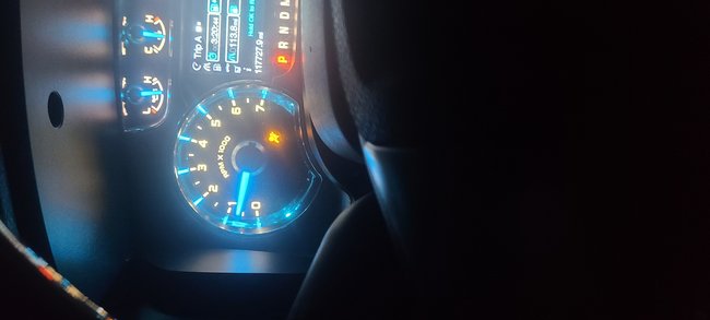

Airbag light turns on when I step on the brake pedal
2014 FORD F-150
117,000 MILES • 3.5L • 6 CYL • 4WD • AUTOMATIC
CARLOSPC1990
  • 10 POSTS
When I start the truck all lights come on as normal and turn off as should. The moment I step on the brake to put it in gear the airbag light comes. Thought it was a seat belt sensor I latched all belts and nothing. Heard it could be a crash sensor located by the radiator and replaced that, still the same result. Please help.

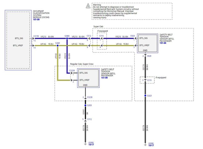

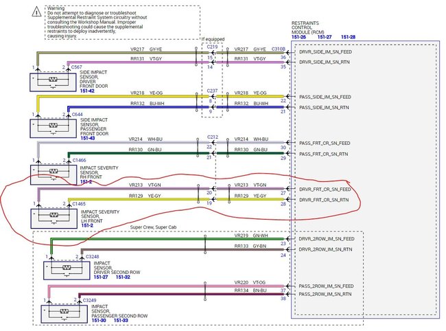

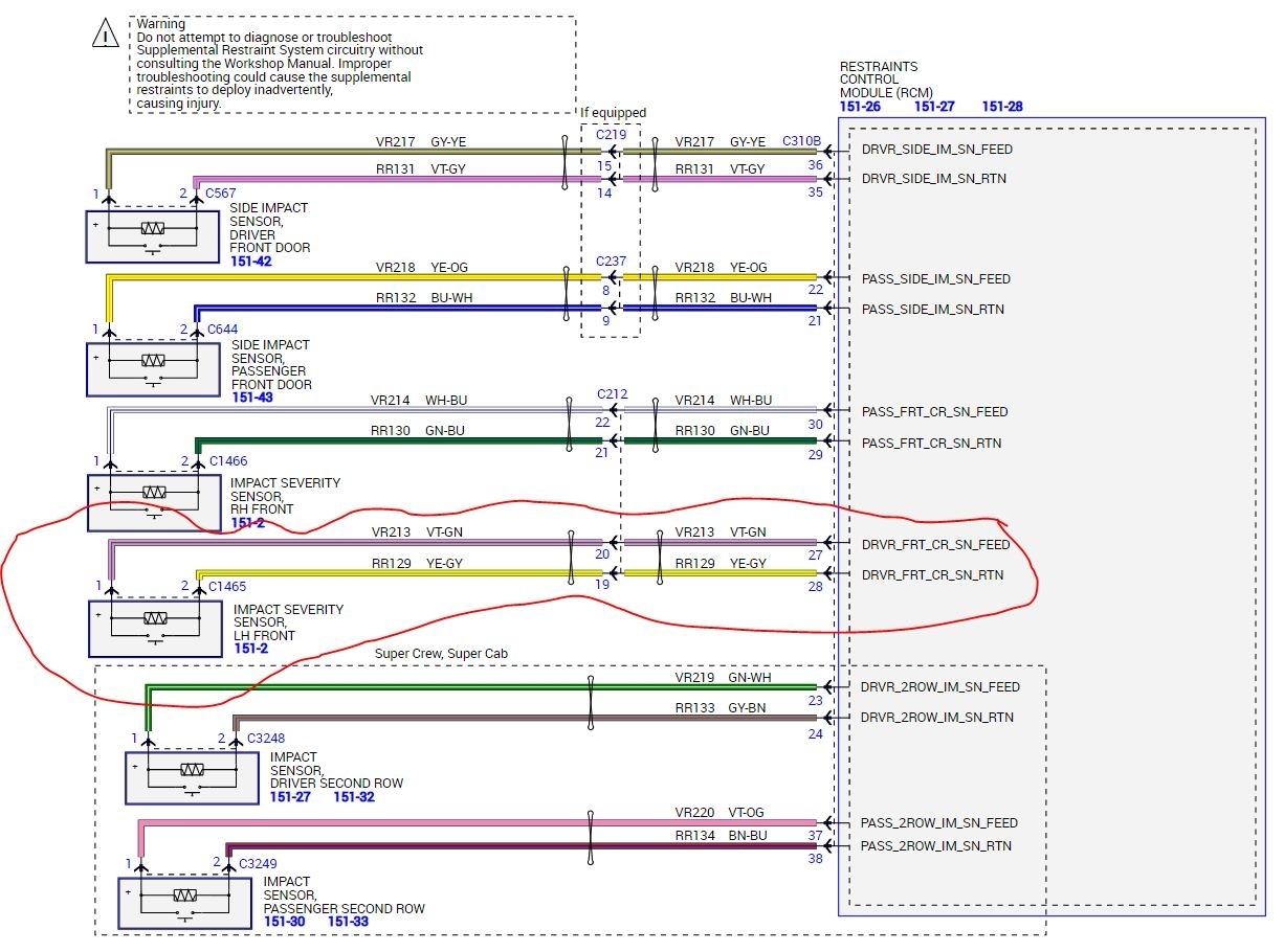

B0090... Left frontal restraints sensor.
Feb 24, 2021 at 9:15 AM
CARLOSPC1990
  • 10 POSTS
Also saying P1703.
Feb 24, 2021 at 11:27 AM
STEVE W.
  • CAR REPAIR CONTRIBUTOR
  • 15,167 POSTS
Is there a suffix code for either of those two? The B0090 could be one of 5 different issues all relating to the left front impact sensor
B0090:11 - Left Frontal Restraints Sensor: Circuit Short to Ground
B0090:4A - Left Frontal Restraints Sensor: Incorrect Component Installed
B0090:81 - Left Frontal Restraints Sensor: Invalid Serial Data Received
B0090:93 - Left Frontal Restraints Sensor: No Operation
B0090:96 - Left Frontal Restraints Sensor: Component Internal Failure
The 4A and 81 codes are common if the replacement part is not the OE specific part for that exact truck, they are seen a lot if a factory part isn't used. These can be verified using an OE level scan tool that can talk to the SRS module and extract that data.
The 11 and 96 sections require a scan tool that can read the data pids to determine what the RCM is seeing for resistance on the circuit. This cannot be tested without that ability.

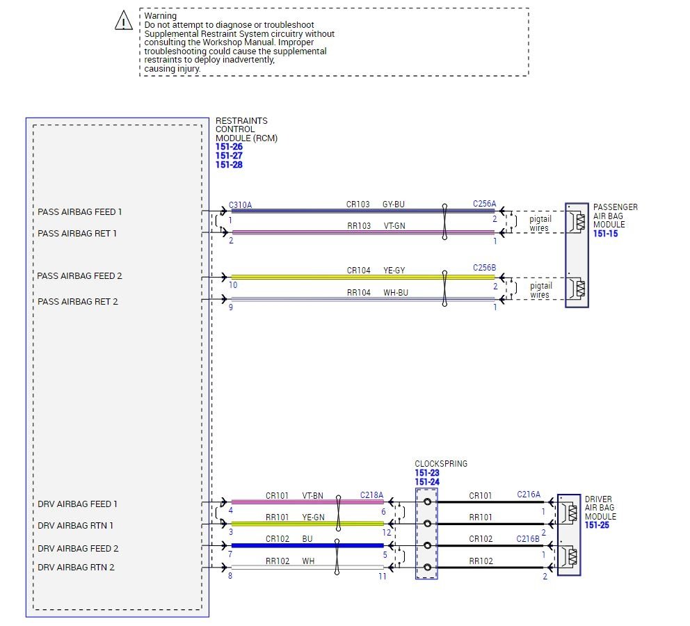

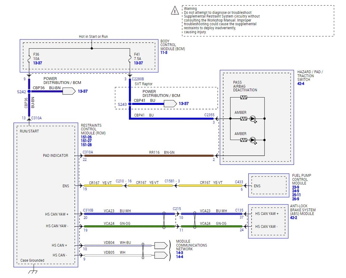

The Restraints Control Module (RCM) continuously monitors the passenger air bag module stage 2 circuits for the following faults:
Resistance out of range
Unexpected voltage
Short to ground
Faulted passenger air bag module
If a fault is detected, the RCM stores DTC B0011:11, B0011:12, B0011:13 or B0011:1A in memory and sends a message to the Instrument Panel Cluster (IPC) module to illuminate the air bag warning indicator.
The RCM analyzes the deployment loop resistance and uses this measurement in combination with an age correction factor to determine if a fault exists. The value displayed in the PID is the deployment loop resistance as measured by the RCM . If the value displayed is lower or higher than the desired range (refer to diagram below), the RCM can set a DTC. As the deployment loop resistance drifts farther outside the desired range, the chance for a DTC increases. The RCM fault trigger threshold may vary as the vehicle ages. Small variations in resistance can occur due to the effect of road vibrations on terminal fit and/or temperature changes. These variables can result in an intermittent fault. For this reason, the test requires the PID value to be within the desired range before the fault is considered repaired, regardless if the module is reporting an on-demand DTC at the time of diagnosis. Following this direction helps make sure that minor changes in resistance do not create a repeat concern. This test uses process of elimination to diagnose each part of the deployment loop circuit including:
Wiring
Connections
Passenger air bag module
RCM
It monitors for a resistance range of 1.7 to 2.78 ohms, outside of this range a code will set.
B0011:11 — Passenger Frontal Stage 2 Deployment Control: Circuit Short to Ground
A fault is indicated when the RCM senses a short to ground on either passenger air bag stage 2 circuit.
B0011:12 — Passenger Frontal Stage 2 Deployment Control: Circuit Short to Battery
A fault is indicated when the RCM senses a short to voltage on either passenger air bag stage 2 circuit.
B0011:13 — Passenger Frontal Stage 2 Deployment Control: Circuit Open
A fault is indicated when the RCM measures greater than the desired resistance range between passenger air bag stage 2 circuits.
B0011:1A — Passenger Frontal Stage 2 Deployment Control: Circuit Resistance Below Threshold
A fault is indicated when the RCM measures less than the desired resistance range between passenger air bag stage 2 circuits.
This pinpoint test is intended to diagnose the following:
Wiring, terminals or connectors
RCM
PINPOINT TEST E : DTCs B0011:11, B0011:12, B0011:13 AND B0011:1A
WARNING: Do not handle, move or change the original horizontal mounting position of the restraints control module (RCM) while the RCM is connected and the ignition switch is ON. Failure to follow this instruction may result in the accidental deployment of the Safety Canopy and cause serious personal injury or death.
WARNING: Never probe the electrical connectors on airbag, Safety Canopy or side air curtain assemblies. Failure to follow this instruction may result in the accidental deployment of these assemblies, which increases the risk of serious personal injury or death.
NOTICE: Use the correct probe adapter(s) from the Flex Probe Kit when taking measurements. Failure to use the correct probe adapter(s) may damage the connector.
NOTE: Most faults are due to connector and/or wiring concerns. Carry out a thorough inspection and verification before proceeding with the pinpoint test.
NOTE: Only disconnect or reconnect Supplemental Restraint System (SRS) components when instructed to do so within a pinpoint test step. Failure to follow this instruction may result in incorrect diagnosis of the SRS .
NOTE: Always make sure the correct SRS component is being installed. Parts released for other vehicles may not be compatible even if they appear physically similar. Check the part number listed in the parts catalog to make sure the correct component is being installed. If an incorrect SRS component is installed, DTCs may set.
Enter the following diagnostic mode on the scan tool: Self Test — RCM .
Was DTC B0011:11, B0011:12, B0011:13 or B0011:1A retrieved on-demand during self-test?
Yes This fault cannot be cleared until it is corrected and the DTC is no longer retrieved on-demand during self-test.
For DTC B0011:13 or B0011:1A, GO to E2 .
For DTC B0011:11, GO to E8 .
For DTC B0011:12, GO to E10 .
No This is an intermittent fault when present as a Continuous Memory Diagnostic Trouble Code (CMDTC) only.
For DTC B0011:13 or B0011:1A, GO to E13 .
For DTC B0011:11, GO to E14 .
For DTC B0011:12, GO to E15 .

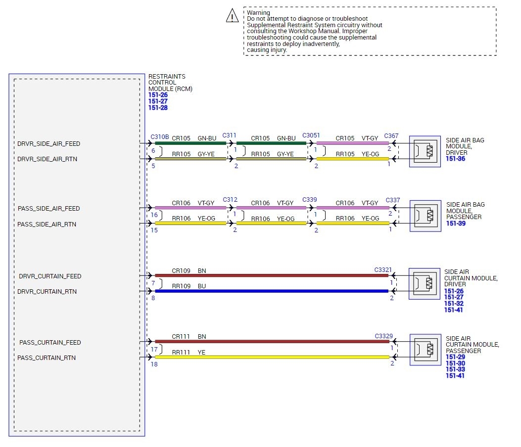

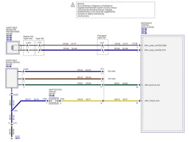

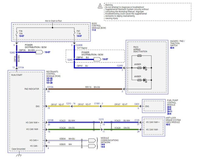

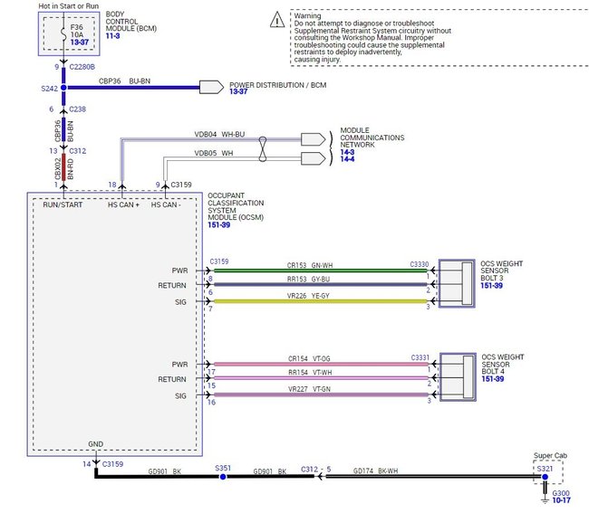

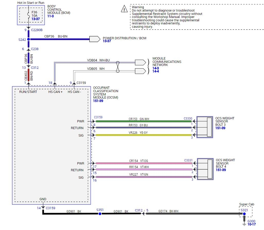

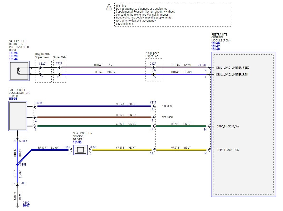

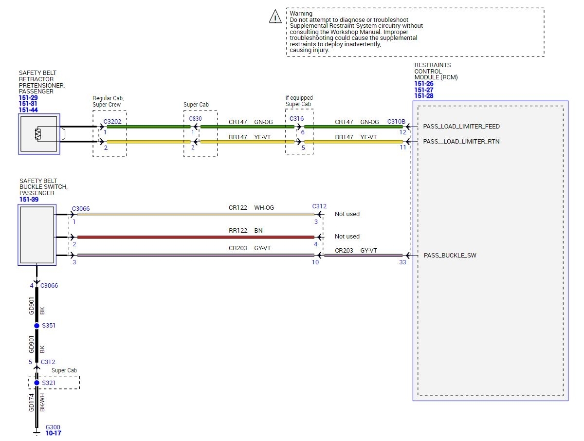

Attached are the wiring diagrams for the testing, depending on which section of the E tests you need to do. The testing in most cases uses a scan tool and a multimeter to measure the voltages at the various connections as the scan tool cycles the tests or reads the results through the RCM.

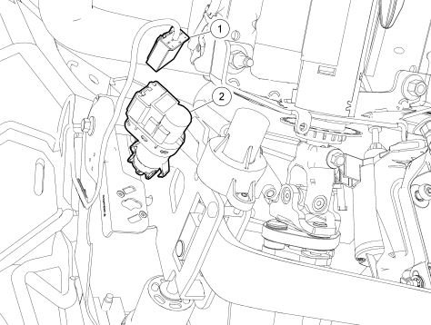

You mentioned changing one of the sensors, was it the left (drivers side) or right one that you changed?

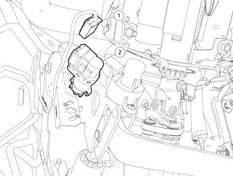

P1703 can be one of two different issues,
P1703 - Brake Switch Out of Self Test Range
P1703 - Powertrain Control/Emissions Diagnosis (PC/ED)

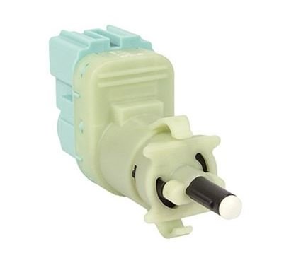

The P1703 code however is most likely a brake pedal position sensor issue.
There was a recall done on these trucks for it and it involved replacing the switch to repair the problem. The switch is very easy to replace. If you look under the dash at the hanger assembly for the brake pedal you will see the switch. To replace it you disconnect the wire connection, the turn the switch body about 1/8 of a turn counterclockwise to release it, then just pull it out. Reverse the process to install the new one.
