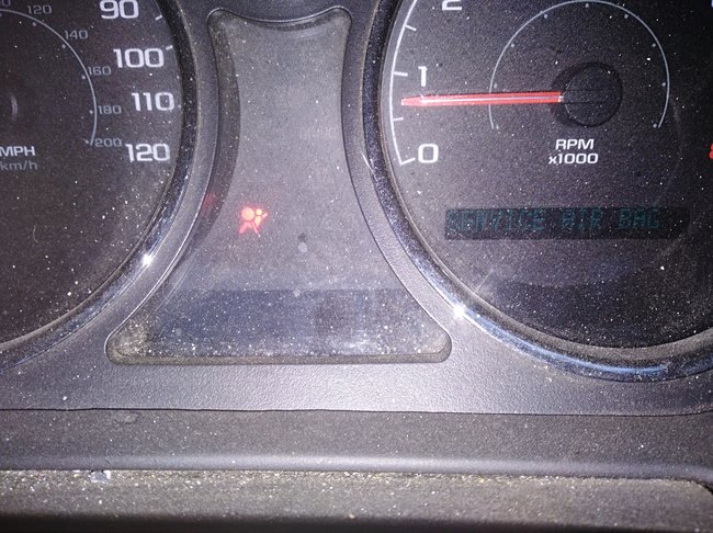

This is what shows on my dash.
*ignore the little yellow U with the ! In the middle. It just means I paid $4.00 four a tire gauge vs paying $300.00. For sensors to be put in the tires.
Wednesday, December 4th, 2019 AT 4:21 AM

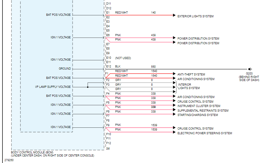

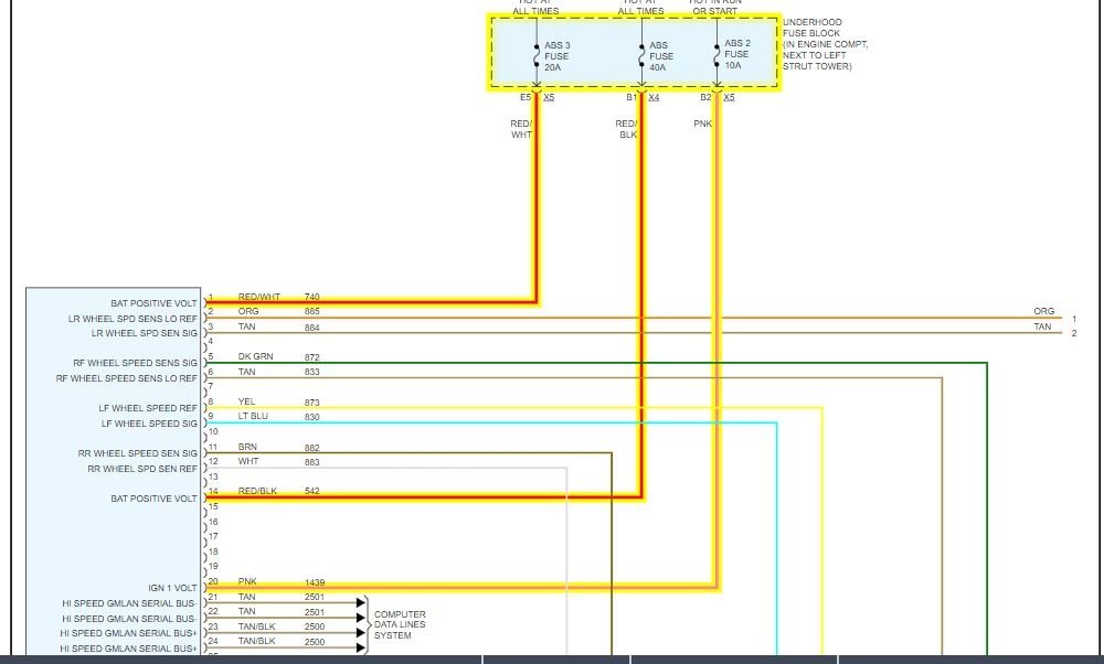

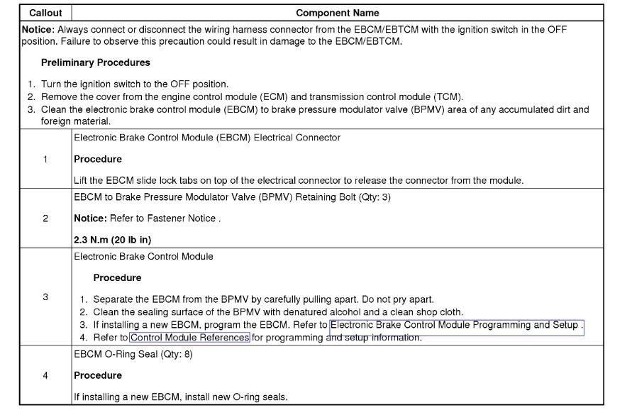

Okay if you have no codes, and I hope their scanner can read ABS codes, then you need to verify powers to the module. If you have all 3 powers to the module, then you need a module.
I attached a picture and a diagram for you to view.
Wednesday, December 4th, 2019 AT 5:42 AM

Here's a pic of what's showing on my dash.
Wednesday, December 4th, 2019 AT 10:22 AM

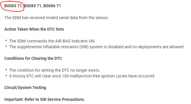

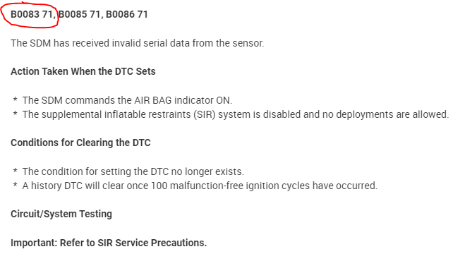

Scanner finally arrived.
On SRS it says:
B0083-71 (1-1)
Left front impact SENSOR - invalidate data
Monday, December 16th, 2019 AT 4:36 AM

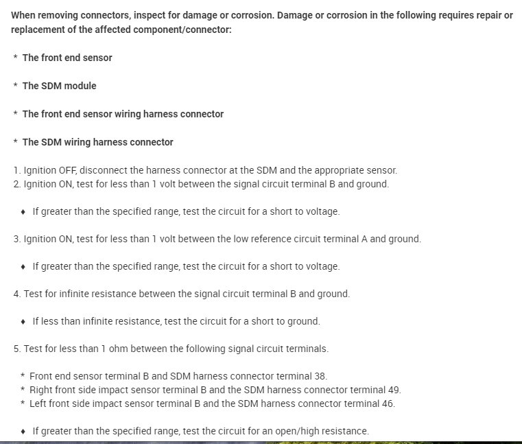

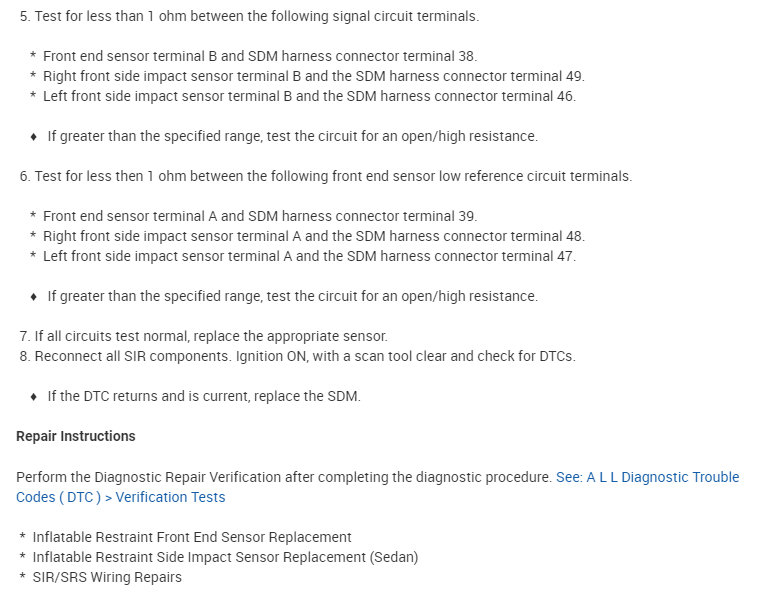

Hello, I'm Danny.

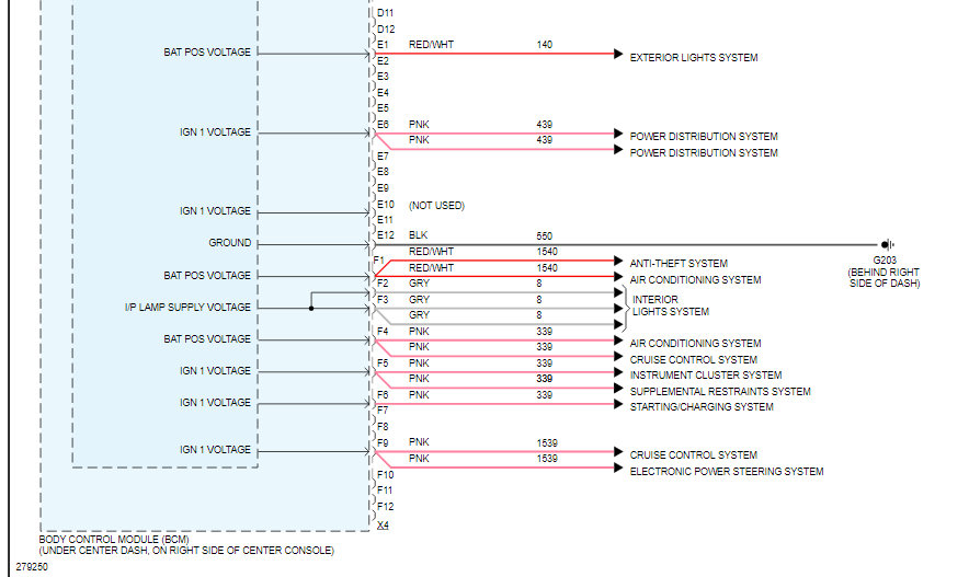

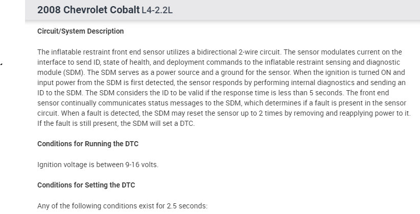

Here is what you will need to do to test diagnose that particular code: This code is relevant to the SRS-SDM (supplemental restraint system-- sensing and diagnostic module) It sounds like you are having an issue with non-communication between the sensor to the module. I've attached step-by-step troubleshooting pictures to diagnose below. Hope this helps and let us know what you find. Thanks again for using 2CarPros.
Monday, December 16th, 2019 AT 5:17 AM

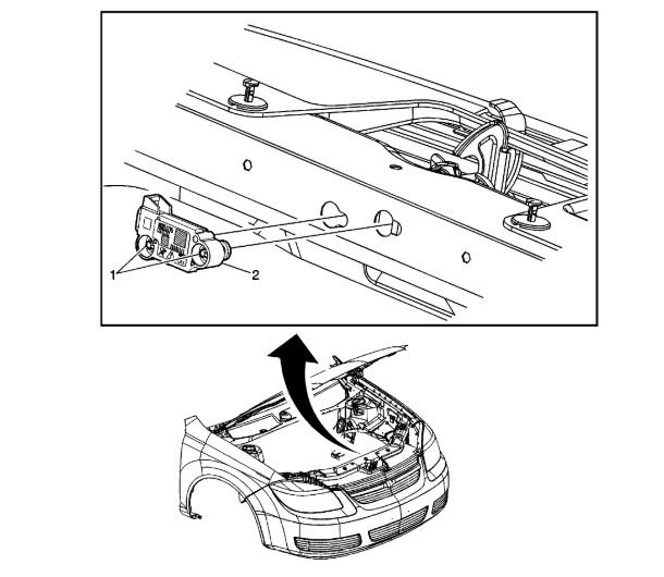

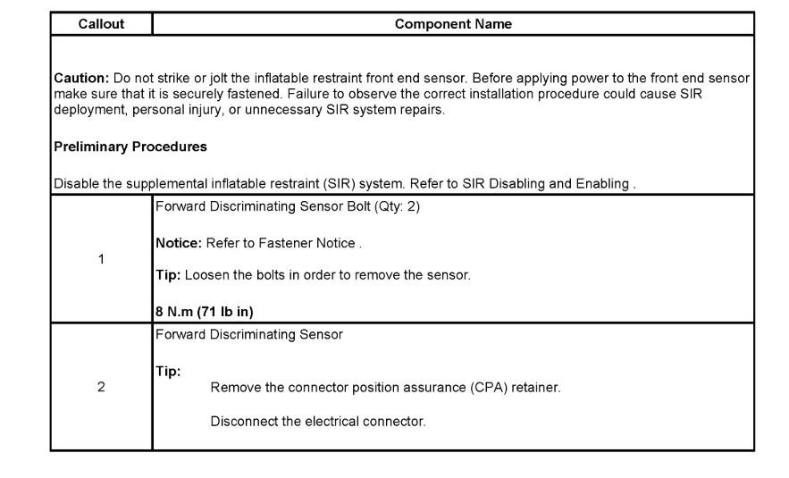

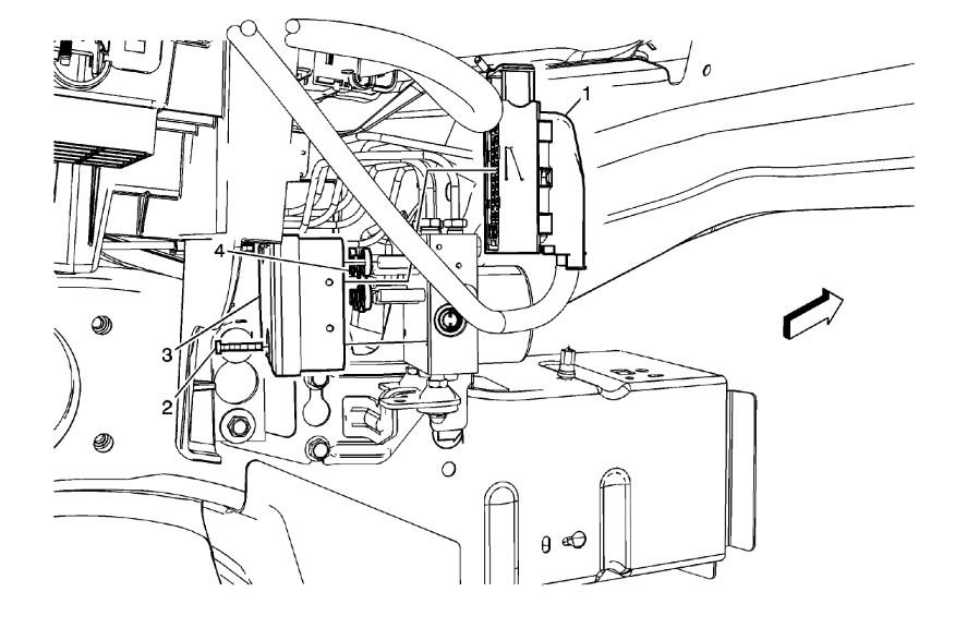

Just to add to Danny's post, the most common issue is the sensor itself. I attached the location and procedure for you.
Monday, December 16th, 2019 AT 6:07 AM
