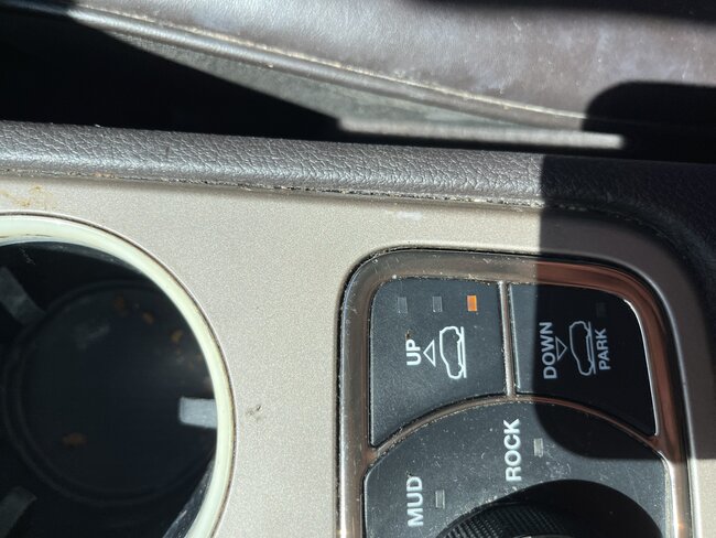

I hear the pump now.
Monday, October 9th, 2023 AT 9:15 AM
BHAMDOC1973
MEMBER
2,018 POSTS
It's gone up. How do I get it to go into the down/park which I guess is what I need to have it on? As in just parked level?
Monday, October 9th, 2023 AT 9:19 AM
BHAMDOC1973
MEMBER
2,018 POSTS
Is this where it should be?
