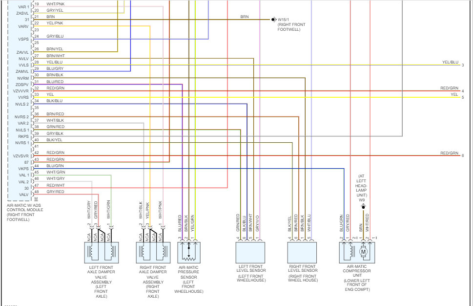

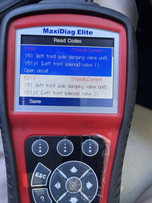

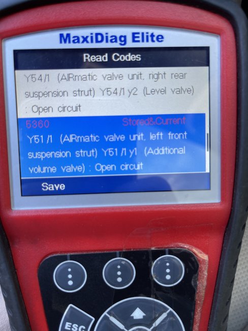

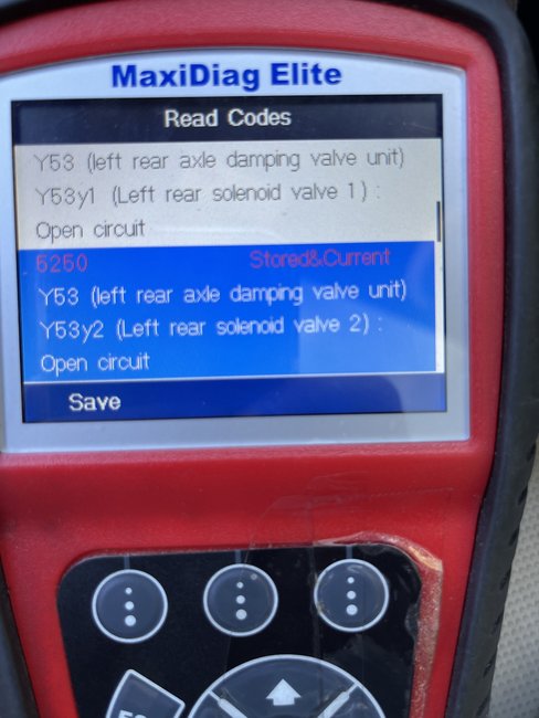

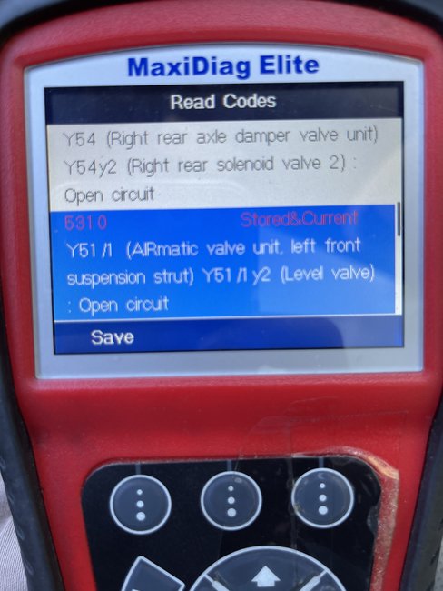

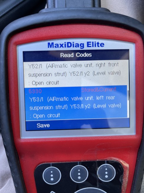

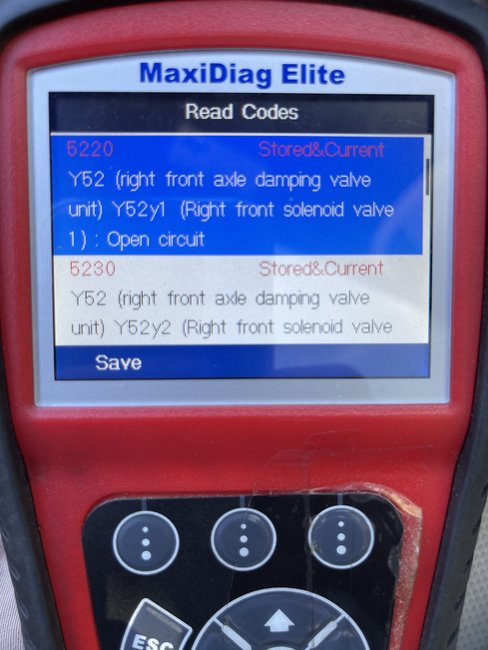

08 e550 4matic, sits right, not sinking, drives excellent, but has the malfunction suspension light on. Pulled codes and they are below. Am sure they are all corrected. Where would you start?

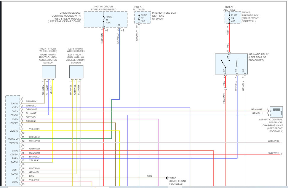

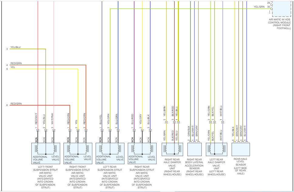

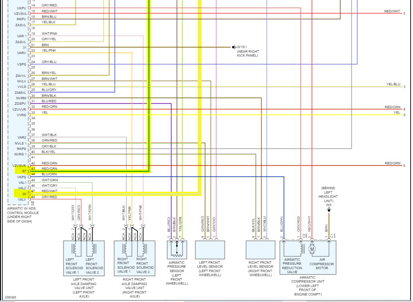

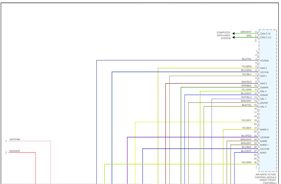

I tried looking up each code and they weren't listed in my manual. However, I noticed that they all indicate an open circuit. Have you checked for damage to the air-matic control module in the vehicle?

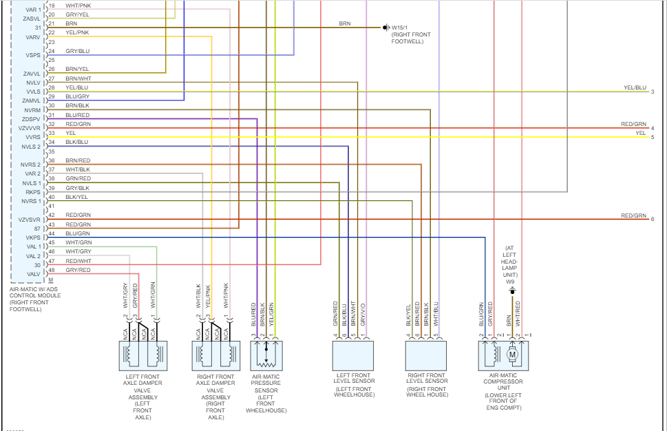

Let me know. Also, I attached the wiring schematic for the circuit, so you have a reference.
Let me know what you find.

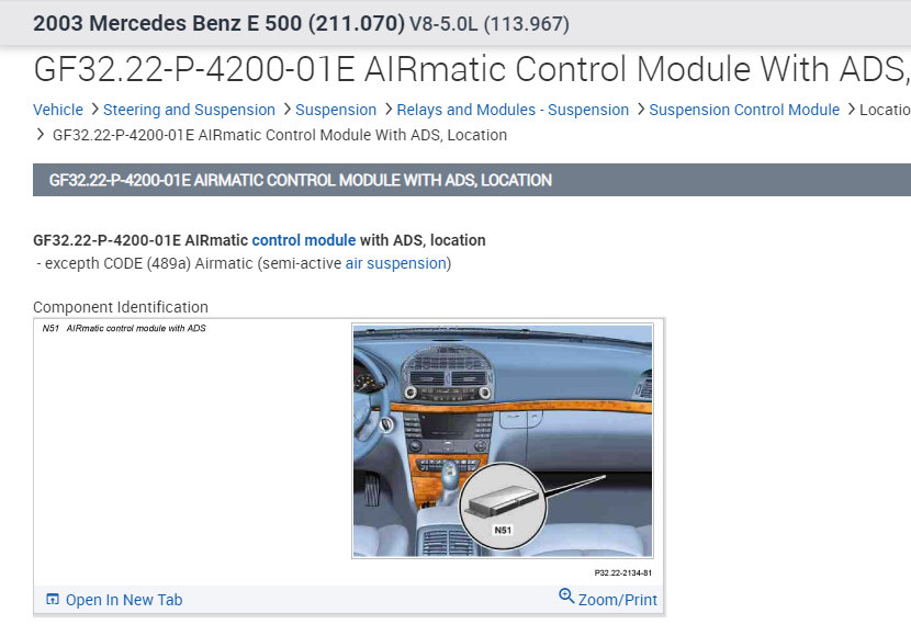

Is the airmatic control module on the passenger side floor?
Wednesday, September 28th, 2022 AT 7:30 PM
  • 110,192 POSTS
I believe that is correct. I did find a pic of the location and attached it below.
Let me know if this helps.
See pic below.

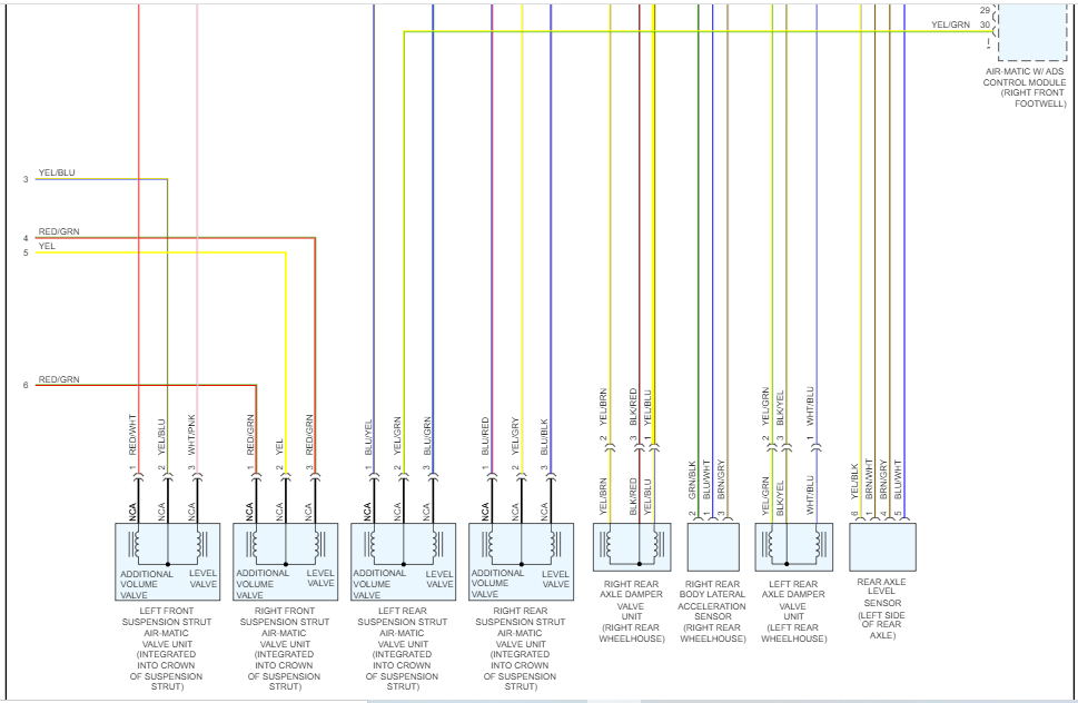

All good by module. Looked at front sensors on top of strut found that both the air hoses and the electrical connections are off on both struts. They have been replaced by a conversion kit on all. But they did not Add the light fix kit. I know where to buy these. Bit pricey but not as high or a headache as replacing air struts.
Thursday, September 29th, 2022 AT 6:48 PM
  • 110,192 POSTS
That would certainly explain the open circuit on everything. LOL Wow, anything to make the day a little more interesting. Regardless, I'm glad you found the issue.

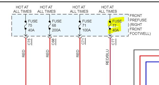

The module I am sure is what is draining the battery. I disconnected the power wire from whatever it is I had it hooked up to, believe it or not I am having issues finding a power source, everything I test with the probe or test light shows power even when car is off, even the blower motor wires, all hot all the time. Does not make sense.
Thursday, October 6th, 2022 AT 9:10 AM
  • 110,192 POSTS

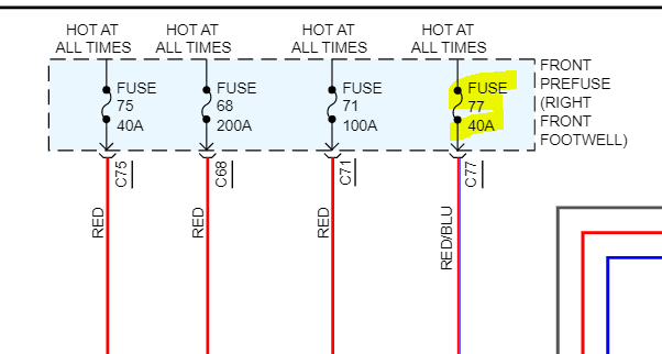

I can tell you that power to the blower motor is sent via fuse 77. It has power at all times. For the blower motor to turn on, a ground path needs to be provided to complete the circuit.
See pic 1.

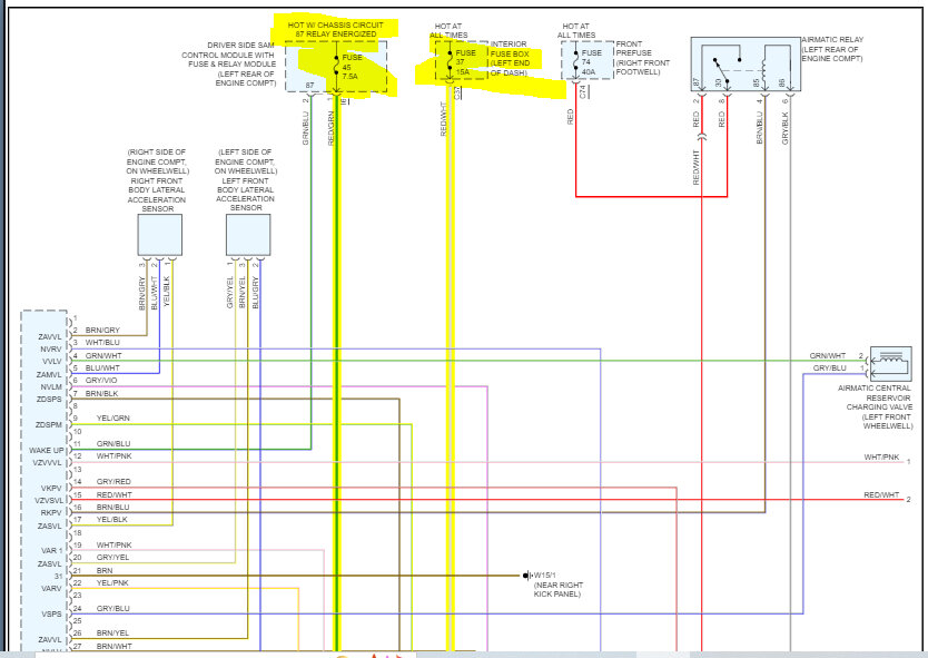

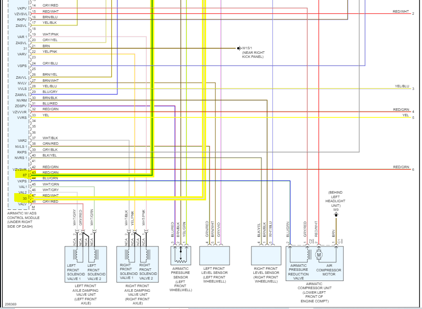

As far as the module is concerned, there are two fuses you need to check. One has power at all times and the other receives power when relay 87 is completed. It's located in the under-hood fuse/relay box.
See the attached pics below.
As far as a switched power supply, under the hood, they basically have power at all times except the aforementioned one requiring relay 87 to be powered.
