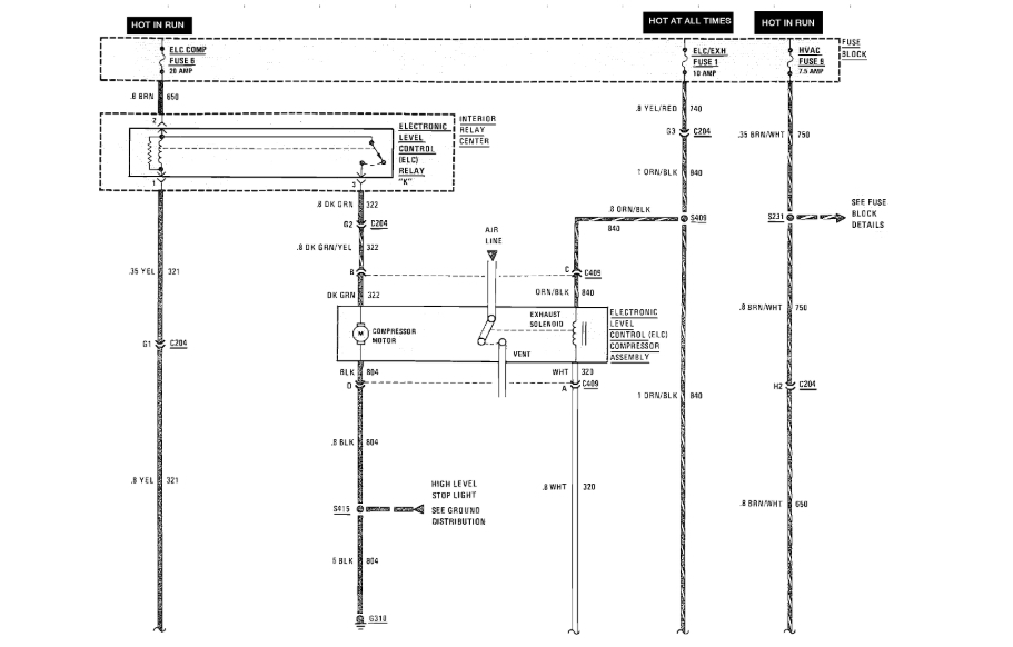

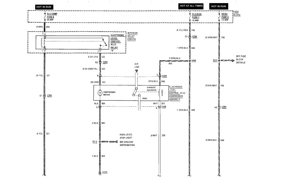

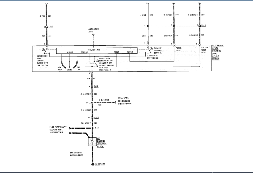

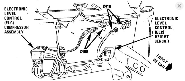

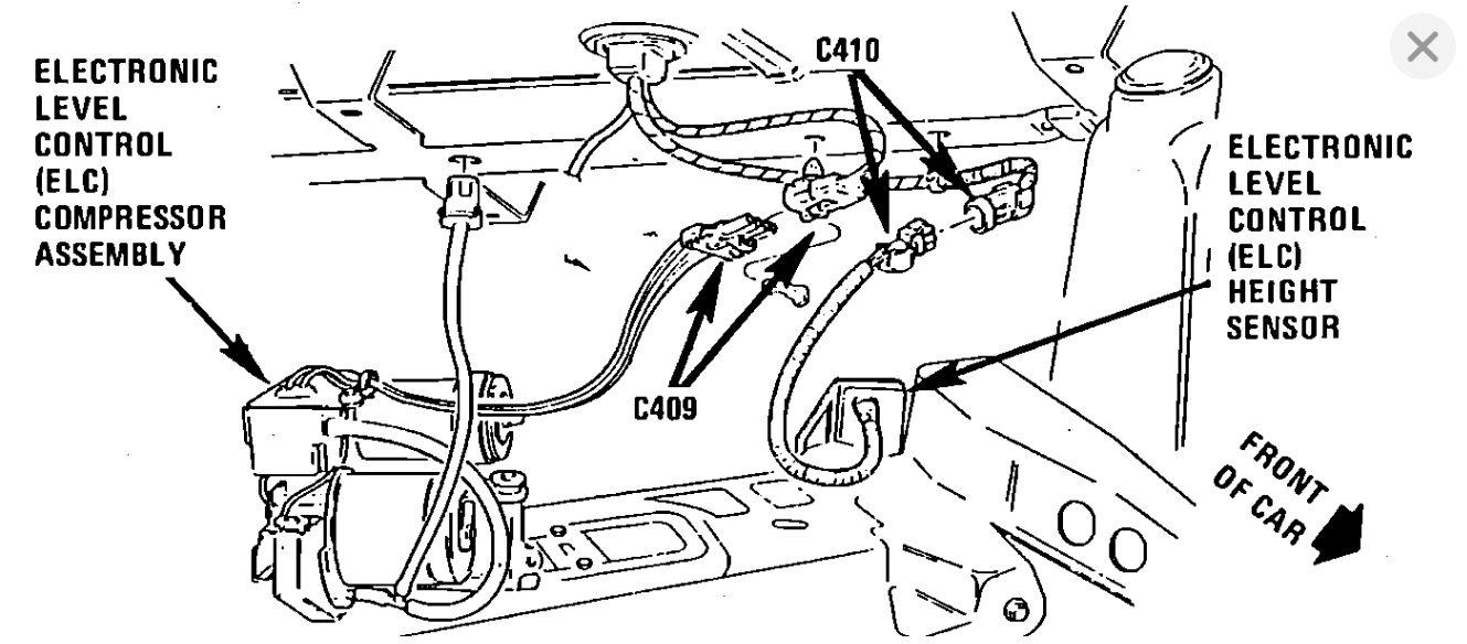

Where is the air pump for air strut?
Sunday, December 23rd, 2018 AT 1:30 PM
MECHANIC
52,796 POSTS
Good afternoon,
The compressor is at the rear of the car underneath on the cross member. I attached a picture for you to view. Check out the diagrams (Below). Please let us know if you need anything else to get the problem fixed.
