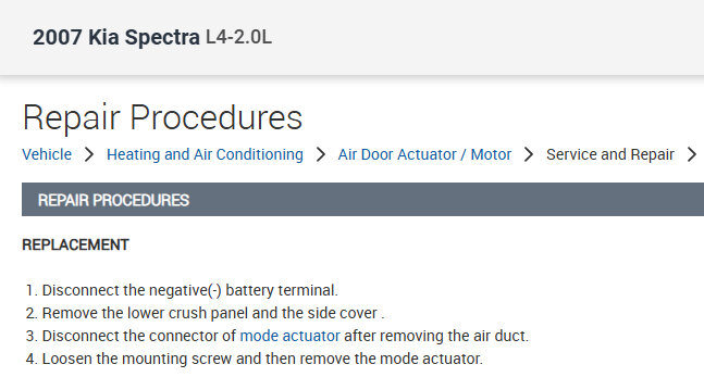

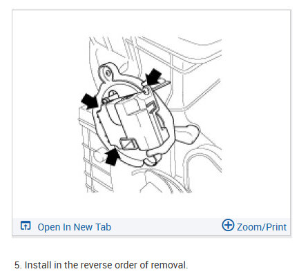

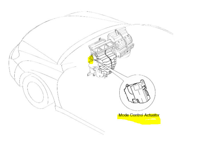

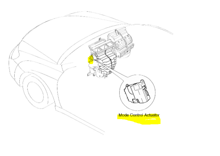

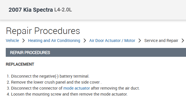

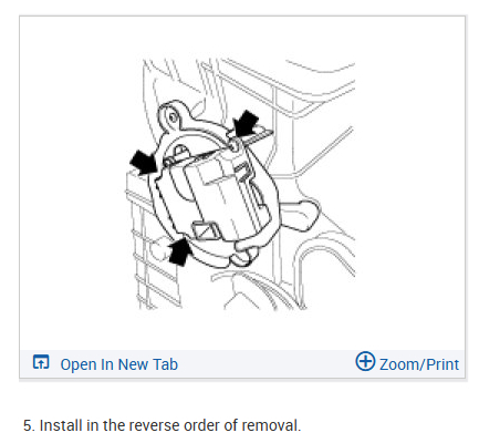

It sounds like the mode door actuator isn't working or something has come apart. The actuator is located under the dash on the driver's side of the HVAC box.
If you look below, I attached a pic showing its location. The remaining pictures are the directions for replacing it.
I hope this helps. Let us know if you have additional questions.
