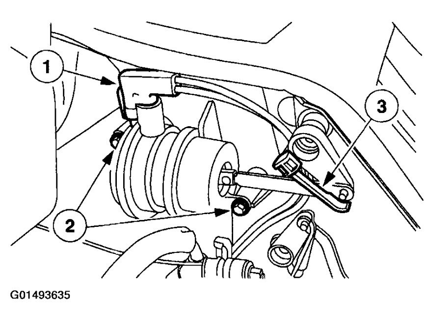

I recently replaced a bad blower motor and after replacing it no air is blowing through the vents any reason why?
Yes the blower is running when I turn it on, even the speeds get higher when I cycle through them. I can feel cold air sitting dormant if I hold my hand to the vent...just no air blowing out.

check for a vacuum leak you may have knocked a line off to a vacuum motor. one in pic says dash must be removed to access but check by blower motor and see if a line is off. if it is just put it back on an dit should work.

Is this under the hood or where the the blower motor was?

no it's probably under the dash it's not a clear pic as far as location you may not be able to see it because to access it you have to remove the dash. if blower motor is under hood then check for a vacuum line off there if it worked prior to replacing motor. it gets vacuum from engine.
