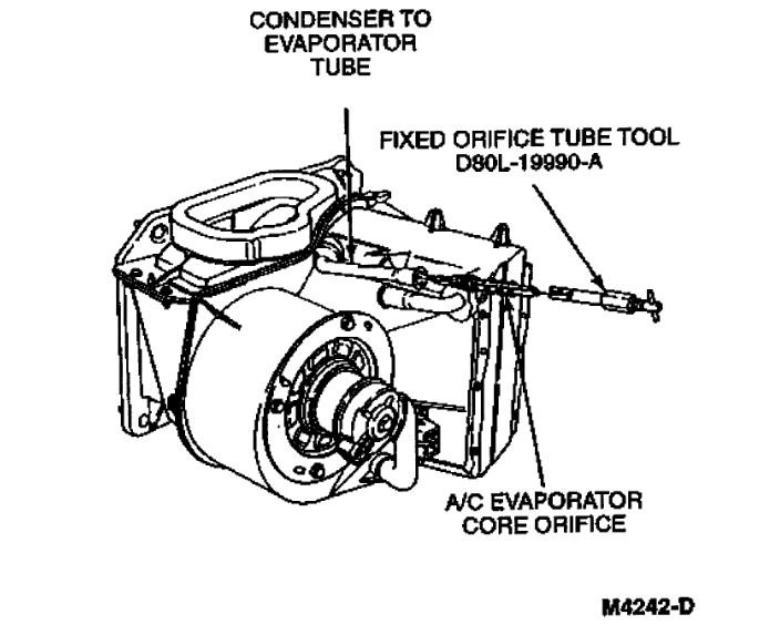

Where is the orifice tube located? Upper or lower line. I have removed the accumulator.

Hello, I am Danny.
It is located in the liquid line. I have attached a photo for you. Hope this helps and thanks for using 2CarPros.

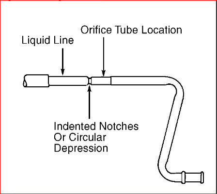

Changing out compresser, accumulator and tube received in kit from Napa.

Good afternoon
I attached a picture of the location for you to view. Make sure you do not put it in backward.
