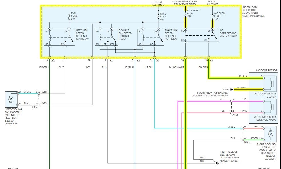

I attached a wiring diagram for you to view. Check the two fuses listed for power on both sides with a test light or voltmeter.

On the A/C compressor clutch relay 87 is hot. Do I jump power from there to 30 to make clutch engage?
+1
Wednesday, June 19th, 2019 AT 4:16 PM
LISAKAYE
  • 11 POSTS
Sorry my husband corrected me on that 30 is hot not 87.
Wednesday, June 19th, 2019 AT 4:18 PM
30 is the hot wire and 87 goes to the compressor. You can jump it with a wire to test to see if the compressor works.
The control side, 86 and 85 are what controls the relay.
+1
Wednesday, June 19th, 2019 AT 4:26 PM
LISAKAYE
  • 11 POSTS
When the jumper is put between the 2 it activates and shuts off the motor immediately.
Wednesday, June 19th, 2019 AT 4:35 PM
Between which 2 terminals?
Wednesday, June 19th, 2019 AT 4:47 PM
LISAKAYE
  • 11 POSTS
30 and 87.
Wednesday, June 19th, 2019 AT 5:16 PM
LISAKAYE
  • 11 POSTS
Could the battery have something to do with this? Because after we change the starter it would only crank in neutral. Then my husband charge the battery and and it crank in park like normal. Prior to this our air was putting out cold. It was when we hook battery back up is when it wouldn’t blow cold. So not sure if battery might not strong enough so the compressor can't kick on
Wednesday, June 19th, 2019 AT 5:22 PM
If the motor shuts off then maybe the compressor is locked up.
If you jump 30 and 87 with the key on and engine off can you hear the compressor engage?
Wednesday, June 19th, 2019 AT 5:41 PM

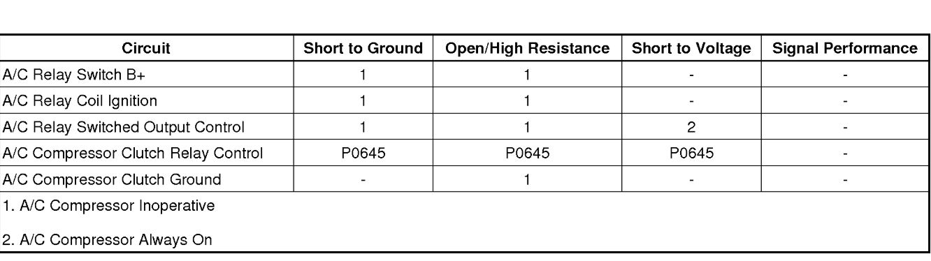

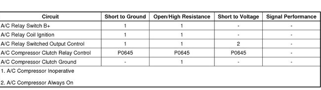

I got it scanned and the code is p0465.
Wednesday, June 19th, 2019 AT 5:53 PM
LISAKAYE
  • 11 POSTS
P0645, sorry.
Wednesday, June 19th, 2019 AT 5:54 PM
Possible issue posted below.
+1
