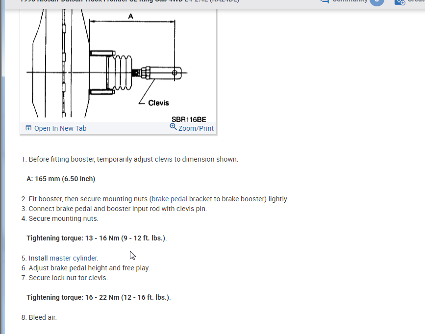

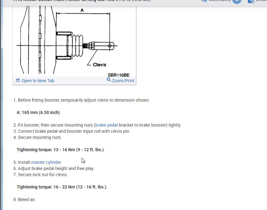

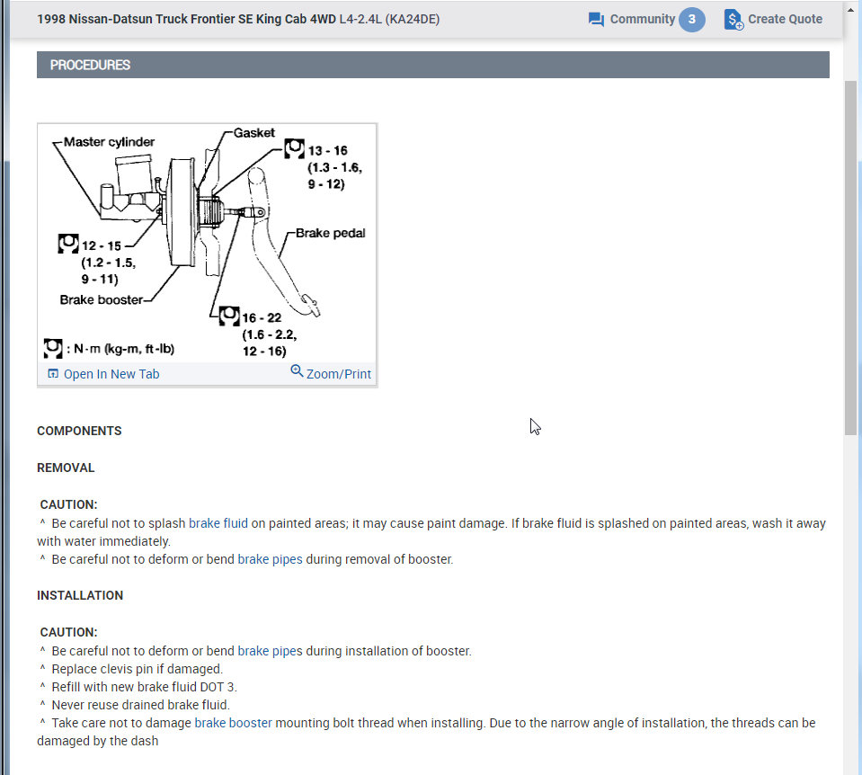

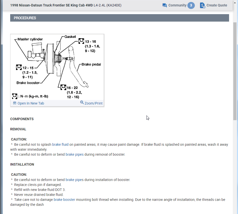

When you press the brakes the booster is what would make this noise unless you have some other vacuum leak. I would check the lines for a leak.
Below is the process from the manual as well on how to replace the booster. There may be an issue with bleeding the air out. Normally you just need to depress the pedal to bleed it but you may have also just received a faulty booster.
Please let us know if you have other questions. Thanks
