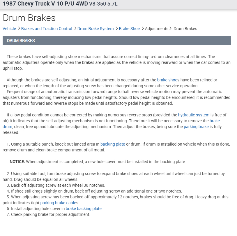

Original miles on the body. How to adjust the drums on the rear wheels?
Monday, May 30th, 2022 AT 10:04 PM
SQM
MECHANIC
6,383 POSTS

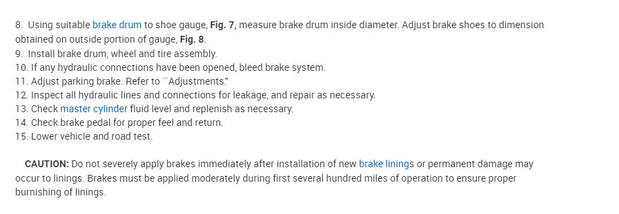

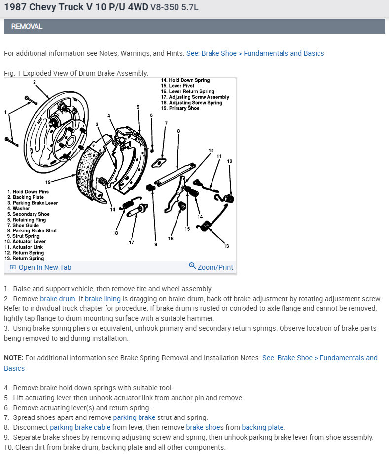

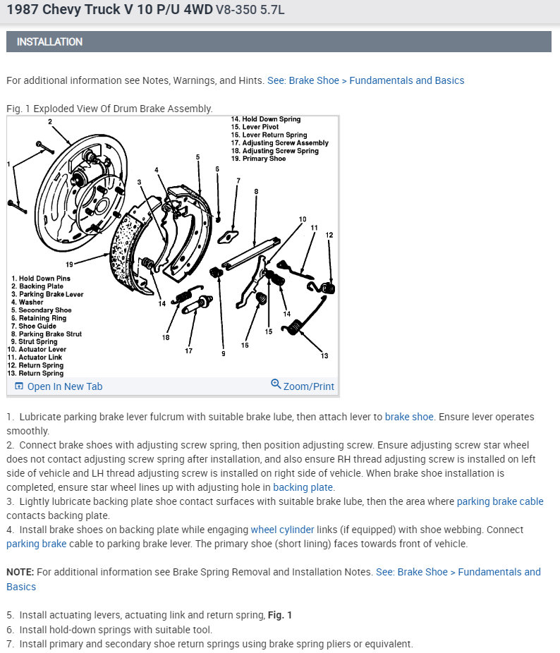

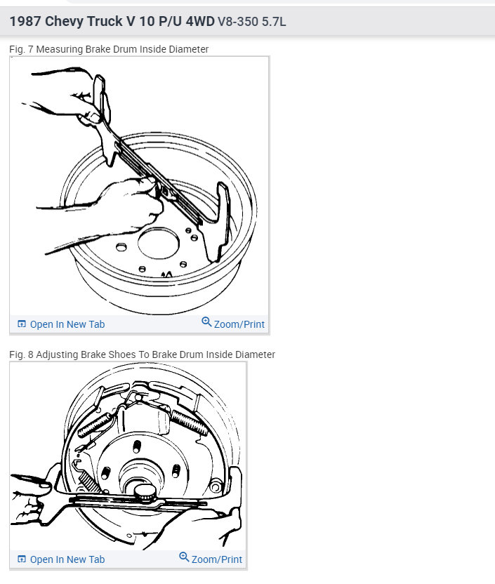

The rear drum brake shoes has an auto adjustment mechanism that will typically need to be adjusted when the shoes get replaced.
https://www.2carpros.com/articles/how-to-replace-rear-brake-shoes-and-drums
I have attached the adjustment procedure below.
Let me know of any questions.
