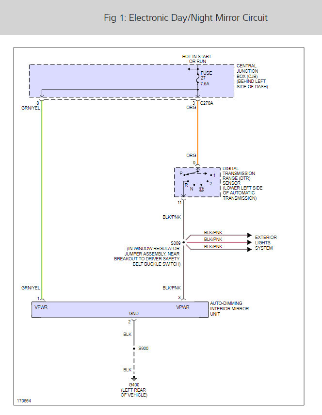

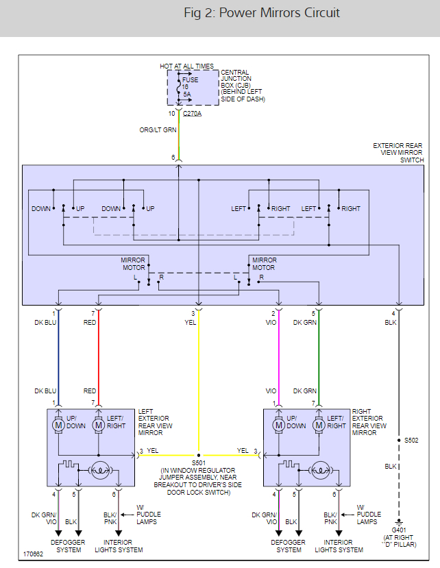

My power mirror has four wires. Is it possible to add a puddle light/mirror? I have the XLS model. What is required?
Dec 4, 2017 at 1:54 PM
  • 54,477 POSTS
Yes, it is possible just tap into the interior light circuit.
Here is the wiring diagram so you can make it happen.
