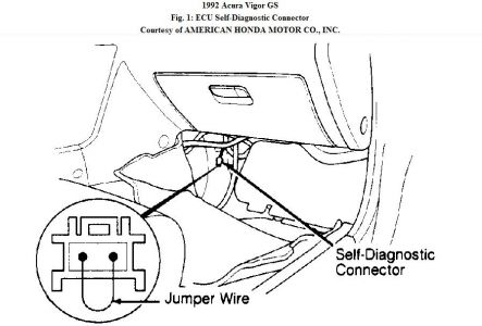

the check engine light comes on then the car doesnt pass 3000 rpms it gets into limp mode I changed the spark plugs, wires timing belt crank shaft position sensor computer and still have problem

You need to retrieve the trouble code to find out what is wrong.
https://www.2carpros.com/forum/automotive_pictures/192750_SCS92Vigor_1.jpg
Bridge the SCS and turn the ignition switch ON. Count the blinking of the CEL to find the trouble code.
