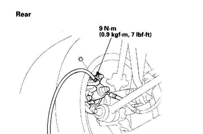

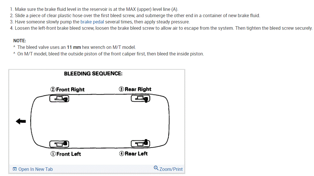

I need a guide to replace the ABS module. Thank you
Apr 17, 2009 at 4:22 PM
  • CAR REPAIR CONTRIBUTOR
  • 110,190 POSTS

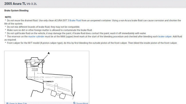

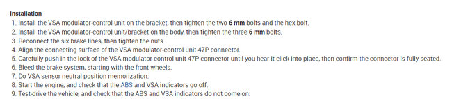

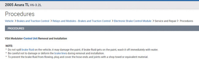

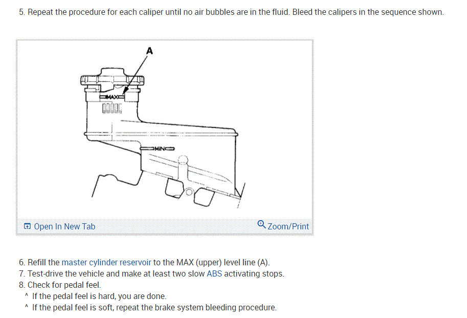

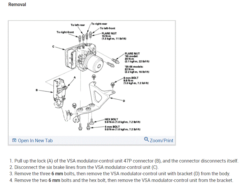

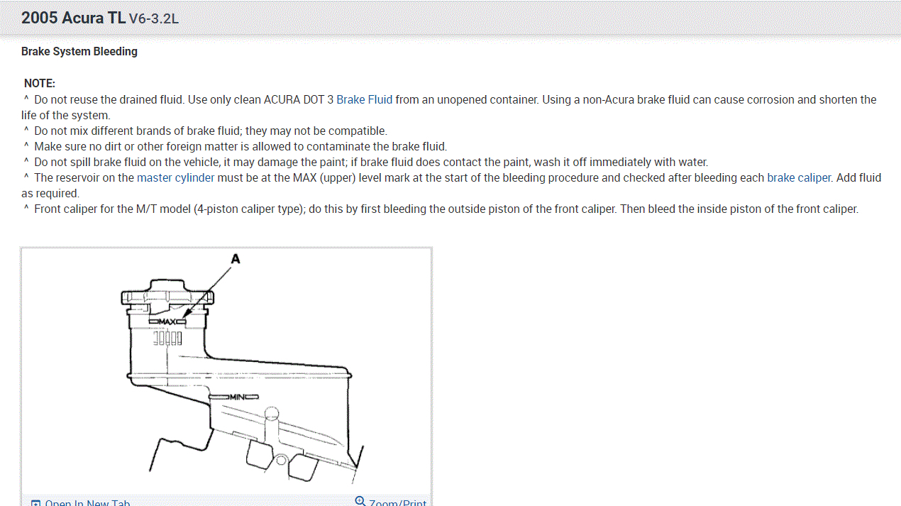

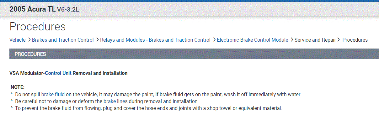

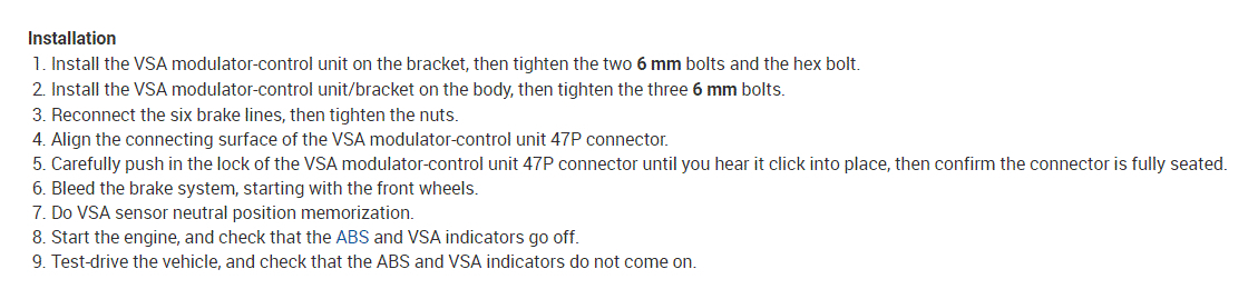

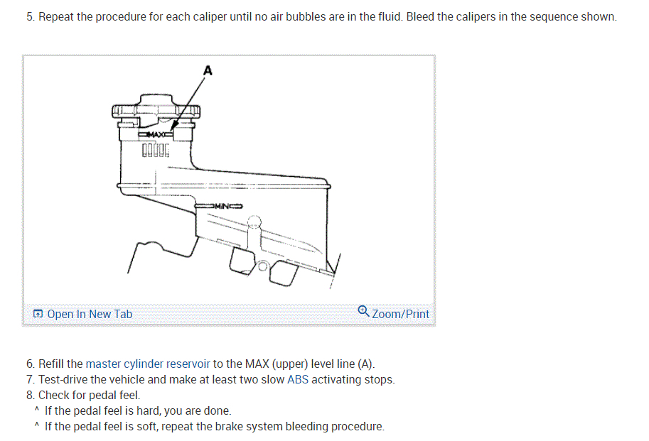

Replacing the module isn't too hard of a procedure. However, you will need to bleed the brake system when finished with the install.
To get you started, here is a link that shows the procedure in general. You can use this as a guide when doing the work.
https://www.2carpros.com/articles/how-to-replace-a-abs-controller

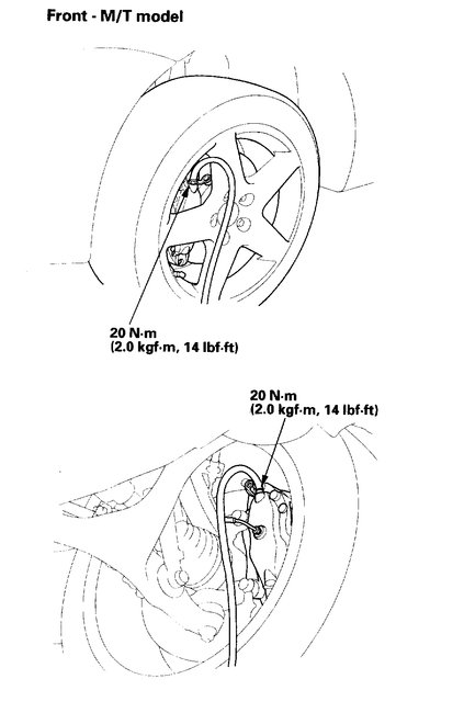

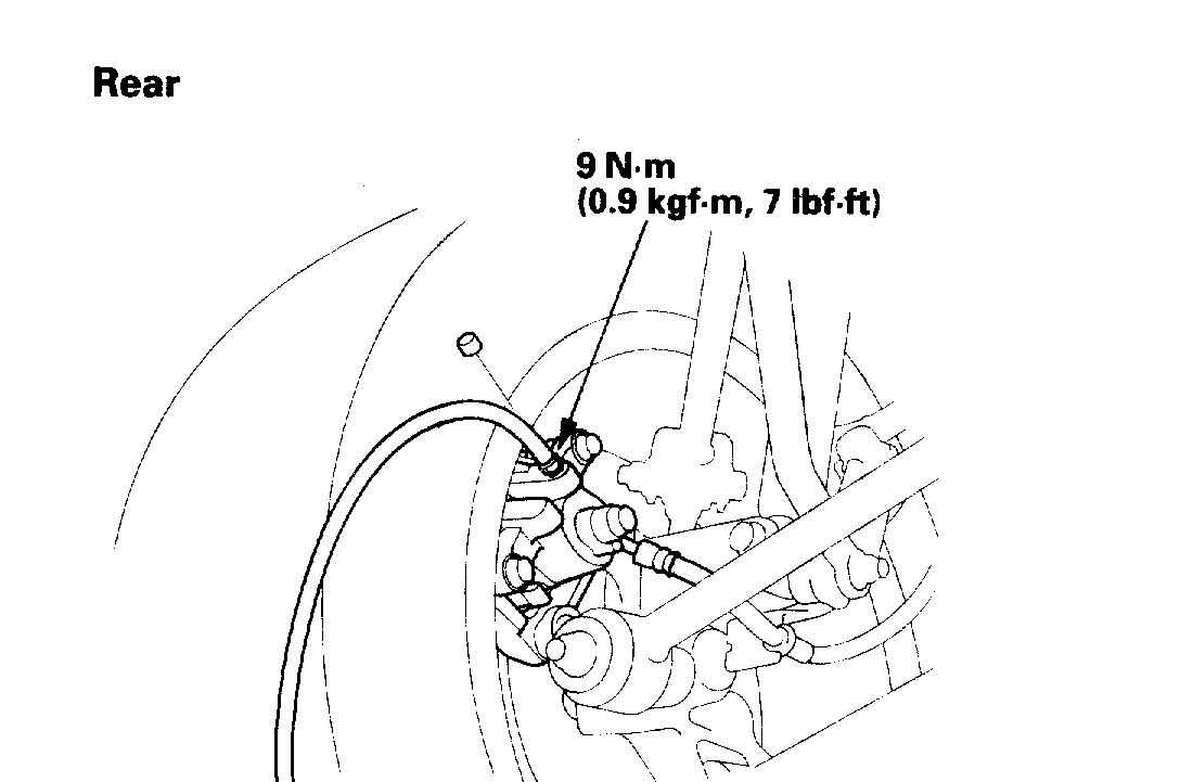

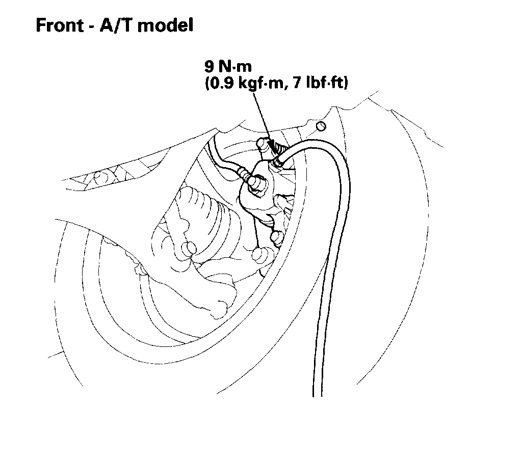

IF you look at the attachments below, they include both the directions and pics specific to your vehicle for replacement. Starting with pic 4 are the bleeding procedures.
