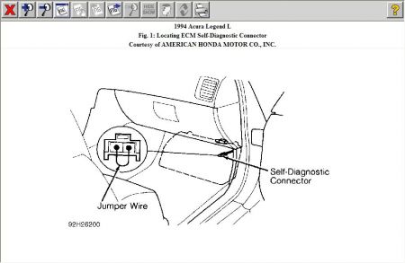

I want to find out how to get the codes manually
Sunday, October 12th, 2008 AT 2:33 PM
MECHANIC
75,992 POSTS
Find the DLC see below and jumper it then turn ignition on and read of the flash on the MIL
