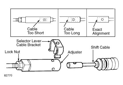

Just had engine replaced, we put the transmission back in fine but when putting the car in gear the wheels will not turn help please

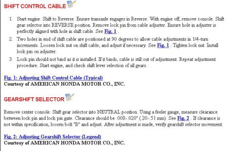

It is probably in your shifter linkage. Try this.
https://www.2carpros.com/forum/automotive_pictures/55316_94legendtrans_1.jpg
https://www.2carpros.com/forum/automotive_pictures/55316_94legendcable_1.jpg
https://www.2carpros.com/forum/automotive_pictures/55316_94legendshifter_1.jpg
