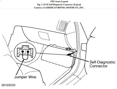

I changed the spark plugs today and when I drove it down the road the check engine light came on wht could b the problem

Hi 5hlw,
You would need to retrieve the trouble codes to know what is triggering the CEL.
Bridge the diagnostic connector and turn ignition switch ON. Count the blinking of the CEL to retrieve the trouble code.
Prolonged blinks = 10 and short blinks = 1
