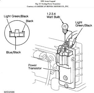

92 Acura Legend - Heater would on work on High for past 2 years. Blower motor died and since replaced and it worked but still only on high. Last week recently stopped blowing on high and works intermitently after driving for awhile, but not always. Seen other forums suggest it might be Blower motor resister but can seem to find out if acura legend has that part or what the exact problem could be

Hi tonyacura, The resistor for yur vehicle is known as power transistor.
https://images.2carpros.com/forum/automotive_pictures/192750_PowerTransistor92LegendFig13_1.jpg
It would affect other speeds but not the erratic on/off operations. Was the blower motor replaced new or used? When problem occurs, try giving the blower motor housing some banging to see if the motor starts working.

Blower motor was new when installed and now blower is not working at all. Tried suggestion of banging with no avail.
My research indicates either power transitor, blower motor relay or blower motor high relay. Hoping not blower motor since just replaced (about 1 year ago).
Anyway to test which is the problem was leaning towards relay since worked on high before blower motor problems but don't want just to keep replacing parts by trial and error.
