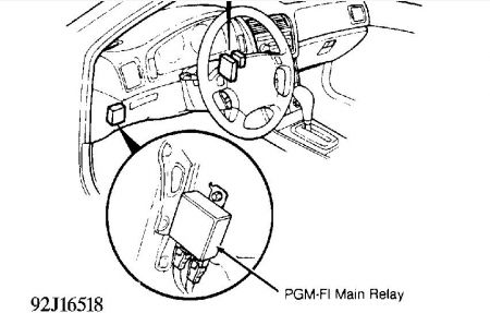

My car will stall after it has fully warmed up and hit the normal operating temperature. After it stalls, it will not start again until the engine has cooled off. Once it has cooled off again it will start up fine, then after ten to fifteen minutes of idling it will stall and not start again until cold. Help!
Monday, March 6th, 2017 AT 3:20 PM (Merged)
KHLOW2008
  • 41,814 POSTS
Hi junbug0024,
Most probably the PGM-FI relay is faulty causing intermittent failure.
