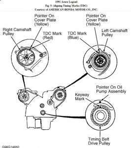

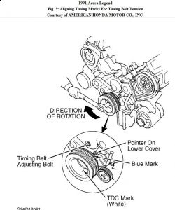

1991 Acura Legend timing belt instalation
T-RATT
MEMBER
1991 ACURA LEGEND
6 CYL
2WD
AUTOMATIC
120,000 MILES
Help
please
Sunday, January 3rd, 2010 AT 6:10 PM
KHLOW2008
MECHANIC
41,814 POSTS
Hi t-ratt,
Here are the markings for the timing belt.
