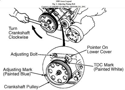

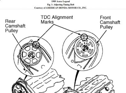

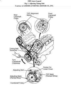

How to line up the both cam and crank shaft for timing.
Saturday, January 2nd, 2010 AT 8:03 PM
KHLOW2008
MECHANIC
41,814 POSTS
Hi thecrawfords4,
Here are various diagrams showing the markings.
