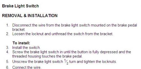

How do I replace the brake light switch? Is it difficult? What kind of tool s do I need? How long should it take me?

Welcome to the forum. My info was fairly generic about removal.
