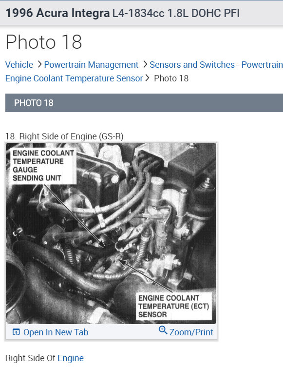

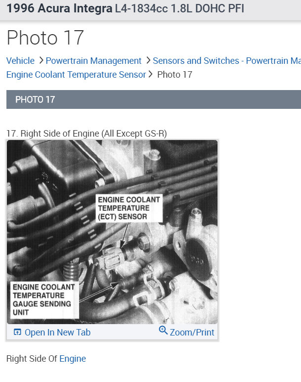

Does the engine coolant temperature sensor control both the condenser fan and the radiator fan? The car sat up for about 6 months, and now neither of the fans will come on. They both worked when we parked it. I was able to jump the fans directly from the battery and they both work. The fuses are fine too. The fans just won't come on. A guy at the auto parts store said that the engine coolant temperature sensor may be the problem. Can that little part be the root of the issue?

The engine coolant sensor is near the distributor here is a guide that will walk you through the steps with diagrams below to show you on your car.

Well, I feel like an ass. I was getting my voltage reading from the temperature sensor that is more towards the intake manifold. The one directly below the distributor does have the correct voltage of 5V. I pulled the back up and ecm fuses and waited 10 seconds before putting them back in and the check engine light went off but came right back on within 2 seconds of the engine running.
