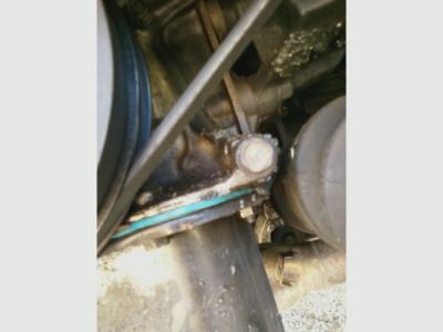

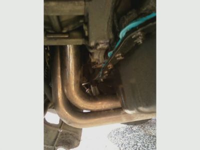

Alright i just got done retiming my car earlier today and while i was marking the pulley with the chalk and noticed that the splash guard had oil residue on it and it looks like the oil pan gasket is messed up again and i already replaced it not even six months ago and im thinkin possibly the gasket behind the pulley might be bad or something cause there seems to be grease clumped up on everything around the pulley whats your idea(s) on this cause im upset that i seem to fix one thing and another thing goes out

and now that ive retimed my car the sputtering and misfiring has died down i had to adjust the timing closer to tdc because its was already perfectly timed on the red timing mark

The grease seems to be from the inner CV joint. Check the boot for tears and the clips to ensure they are secure.
As to oil on the splash shield, the only way to find out is to clean the area and run the engine then check for the source of the leak.
Regarding the ignition timing, do you mean it does not run well when the timing is at the red mark? If yes, you need to recheck the cam timing again.
The rear cam might be out of time.
