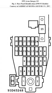

I have a 93 Acura integra and I cannot find where the fuse is for the AC to make it work.

Hi surgeon311,
Fuse #20 (15 A) is for the A/C compressor clutch relay, cooling fan timer and condenser fan motor
