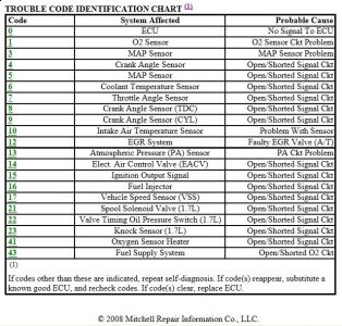

computer on 1992 integra blinks 1 2 7 8 whats that mean? Thank you

There is no Code 2. Can you please verify?
