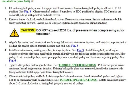

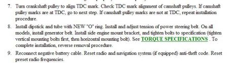

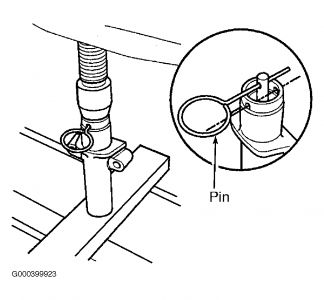

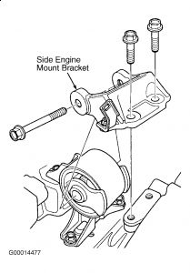

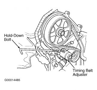

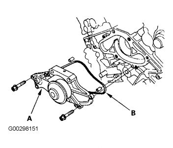

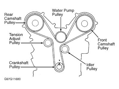

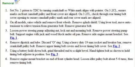

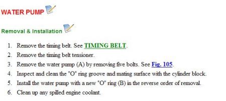

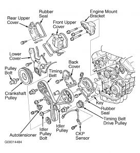

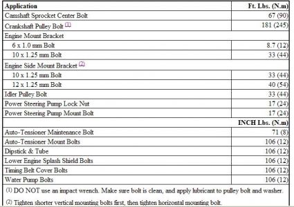

Hello i need instructions on how to replace my water pump and timing belt on my 2001 Acura CL - Type S. If you could please also include the names of the nessasary tools for this job. I do alot of work on my car but this type of job i have never attemted, i cant afford to pay someone to do the work for me so its time i try to learn it myslef and was hoping 2carpros.com would be my backbone in completing this task.
