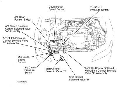

Hi
I have a 1999 acura cl 2.3 with automatic transmission the gave me promble by jerking when I stop only and thats the only promble I get from the transmission jerking plz help me.
Thursday, March 19th, 2009 AT 7:31 PM
MMPRINCE4000
  • 8,548 POSTS
Make sure trans. fluid level is full, otherwise:
Most likely a shift/lockup solenoid is sticking causing the jerking when coming to a stop.
My advice is to take to trusted trans. shop for diagnosis. If solenoid stops working in engaged position, car will stall when coming to a stop and be hard to get going again when restarted.
https://www.2carpros.com/forum/automotive_pictures/108325_acura_1.jpg
