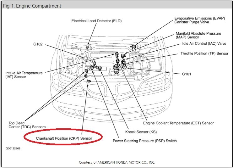

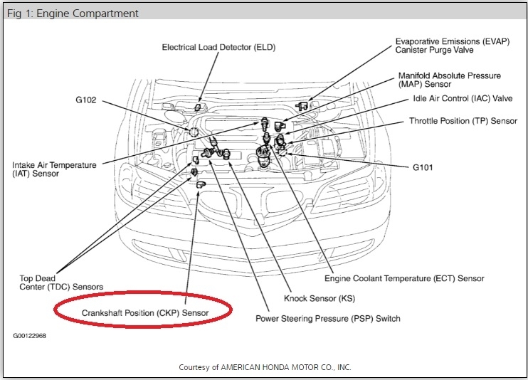

Where is my crank sensor?
Oct 19, 2018 at 5:58 AM
CJ MEDEVAC
  • 11,004 POSTS
Here is the location for the crankshaft sensor. Check out the diagrams (Below). Please let us know if you need anything else to get the problem fixed.

Hi I need help locating the crank position sensor on a Acura cl type-s thanx
Dec 3, 2020 at 12:34 AM (Merged)
JIMMIEBOY
Thanx for your response and I found it. I had to change the timing belt anyway and found the sensor behind the crank pulley behind the timing belt plastic cover. The car I'm working on is a 2001 automatic Acura cl type-s.
