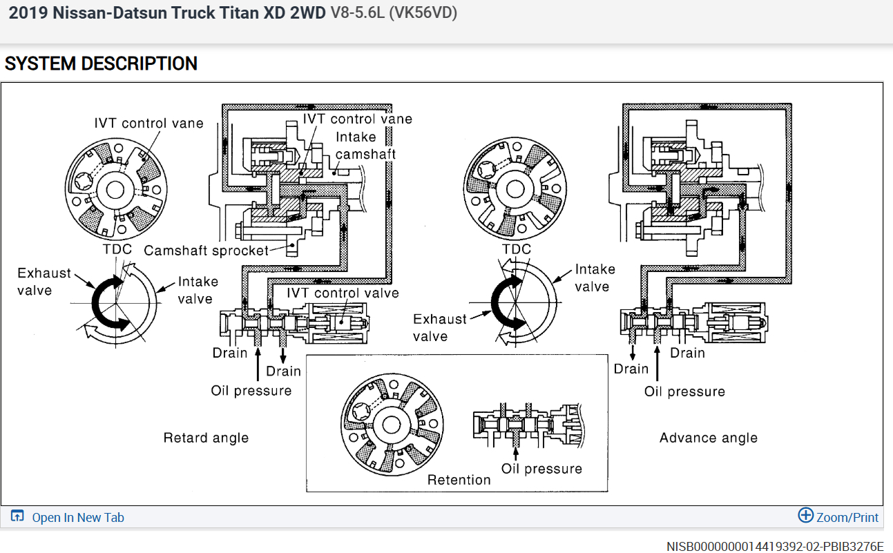

Check engine light is on and giving me a P0022 code. When I hit the gas hard it stalls like it wants to shut off.
Jan 5, 2025 at 4:45 PM
  • 54,477 POSTS

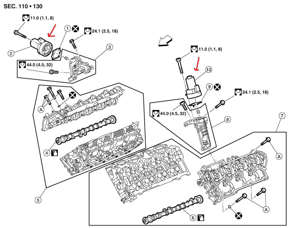

Yep, these codes can come up when the engine oil is low or needs to be changed, so I would do that first and then clear the codes there is a chance the camshaft actuator oil control valve is clogged, or the actuator itself has gone bad.
P0022 - "A" Camshaft Position Timing Over-Retarded (Bank 2)
Here are diagrams to help you understand what is going on. Check out the images (below). Please let us know what happens.
