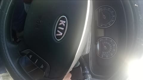

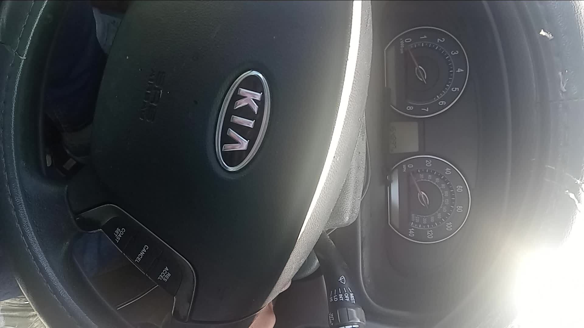

I added the information about the other problems in case it helped to know, as they may have contributed to the engine issue. Here is the video you requested.
On the same note as above, I changed the spark plugs myself some months ago without being precise or equal about tightening them.
With the catalytic converter added, the engine was, prior to the incident, quieter than it is now, as what can now be heard in the video.
The engine now sounds like if I hadn't attached the catalytic converter, with it being this loud again. The attachment of the converter I then created had connected the flange of the manifold to the converter and, more importantly, to the muffler.

The video didn't provide sound during the acceleration that I gave the car.

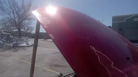

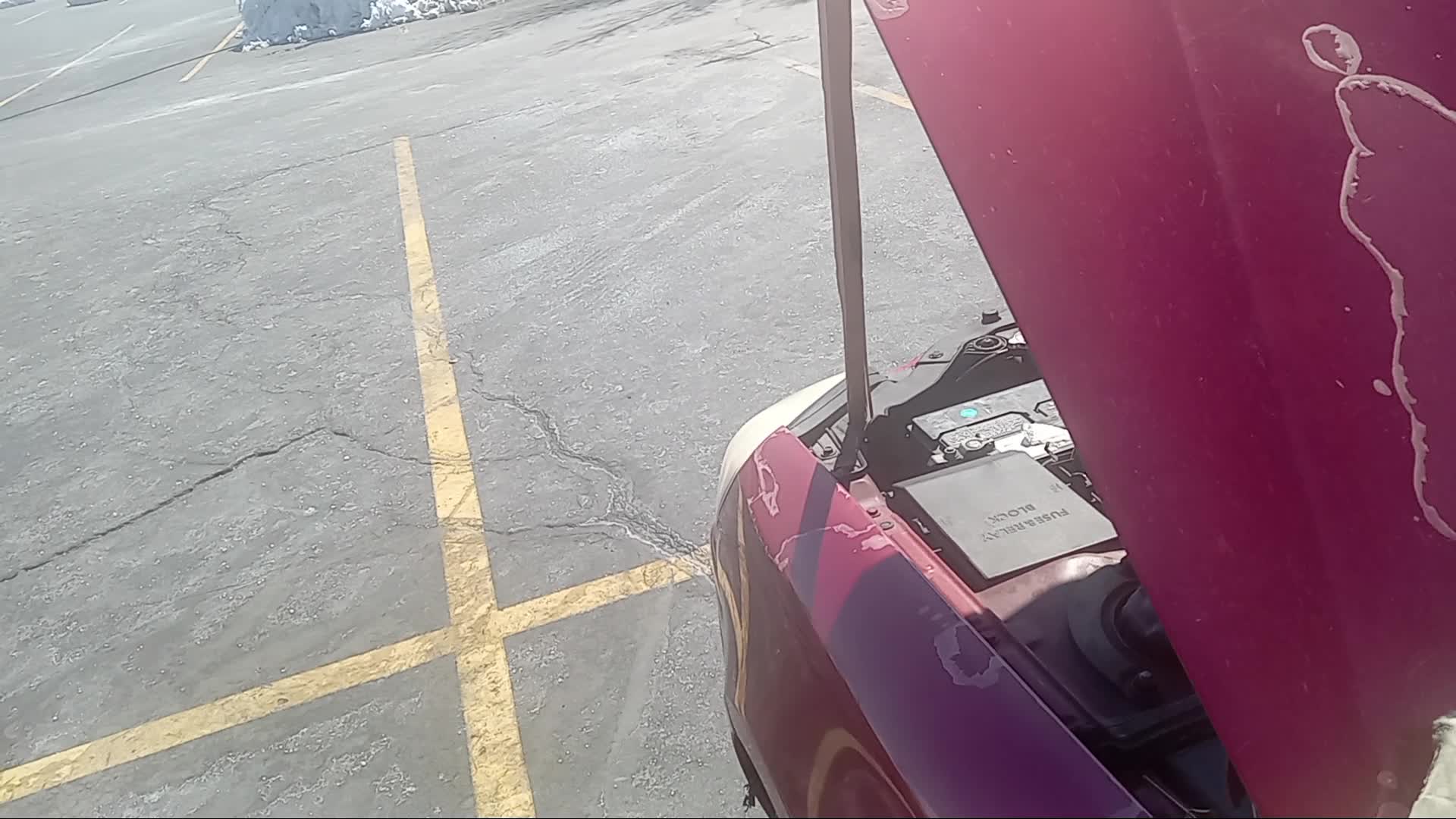

Thanks for the video, that does sounds strange, the video sounds cut out when you revved it which is what I needed to hear. Also can you take the video from under the hood and then have a helped rev it? That would be great, it also sounds like part of the exhaust system has fallen off or is disconnected or you have a rod knock, I can tell more with the next video.

Here's a video of me revving it with the hood open. I had no helper so I couldn't get a front shot of the engine.
Thursday, April 6th, 2023 AT 2:12 PM
2006KIADRIVER
  • 9 POSTS
The video sounds decent, but if more needs to be done then I'll try.
